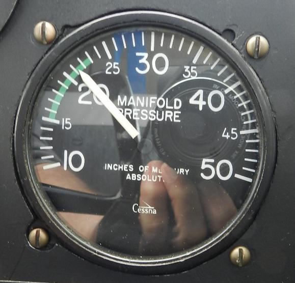

Check your MAP gauge. It should read ambient barometric pressure with the engine off. At full throttle (engine running) you should see about 2 inches less than baro. Any reading less than that is going to result in lower fuel flow than the chart shows. Any conditions less than standard (29.92") is also going to result in lower fuel flow, including at altitude.

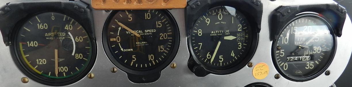

So I flew to Astoria OR today from Pearson KVUO Vancouver, 1.9hr, 9.5gal for a 5gph burn rate.
The gauges looked similar to what I did last weekend up to the San Juan Islands EXCEPT today I was in the 2-3000' altitude whereas last time I was in the nosebleed section 8-9000' .
My vitals today-
RPM 2450-2500
Altitude 2-3000' agl
DA=0-300'
T=55-60F
Cruise manifold about 21", I did check the MP gauge as per John C and it was about as OK as I could tell with ambient. Other vitals....
Going from 4.5 to 5gph the only thing that stands out is my altitude on the low gph was high and the somewhat higher gph was at low altitude. If anything I think the MP was a little lower on the low gph.
As John thought, I checked what logbooks I have (of course some disappeared from previous owners) and I could not find a Beech-Roby prop installation. No 337 either though I think it's on the Type Certificate so it wouldn't be needed.
Full fuel and me, about 120# under gross. Time to climb to 1000'agl 1 minute 36 seconds.
