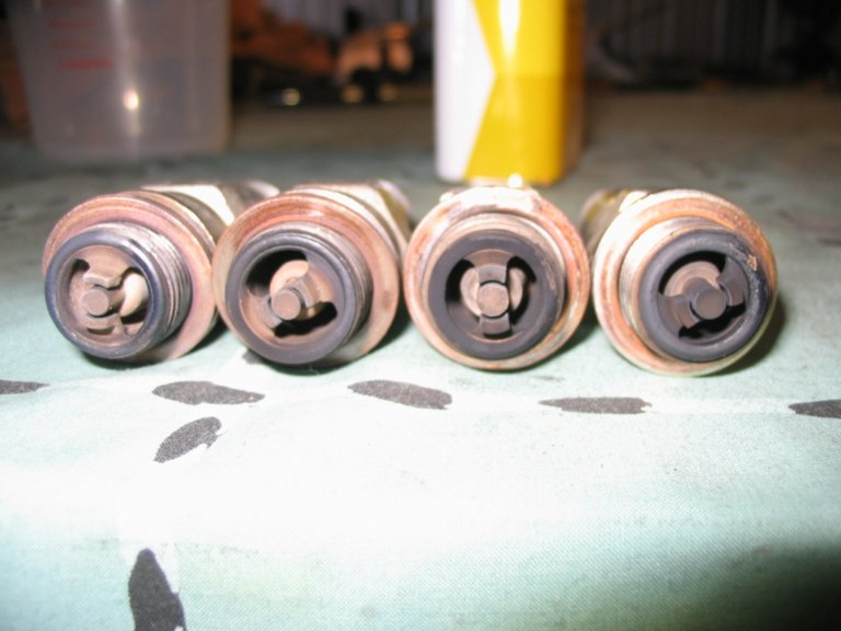

What was your airspeed? I know you said you have a climb prop. Maybe the engine is not loaded very much at 2450rpm if your airspeeds are on the slow side? Nevertheless, those are great fuel economy numbers, sounds like your engine is happy! It would be interesting to see pics of your spark plugs to see what color they are at those low fuel burn numbers.

Here's the typical plug pic, although this was about 18 years ago. REM40EIt would be interesting to see pics of your spark plugs to see what color they are at those low fuel burn numbers
