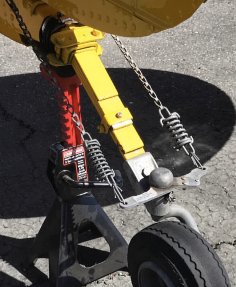

I ran out to the airport real quick, as you can see the previous owner let her sit outside for quite a bit
- IMG_2803 (1).jpg (28.13 KiB) Viewed 8179 times
- Posts: 2807
Re: New Owner
Upside down, too!
That's a Scott 2000. The chains have to be tight, 25# tension, IIRC, or it won't steer.
Here's what you need: https://www.univair.com/tires-wheels-br ... -assembly/

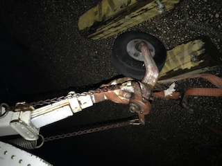

Welcome to the club! I just passed my first year of 120 ownership and I love my plane more every day!
Not to thread jack but, I’ve been meaning to buy a spare set of chains/springs for my tailwheel, the only thing I’ve been able to find is that kit on univair, it says for Scott though (I have the maule), any suggestions on where else to look?
Thanks,
Thanks,
- Posts: 2807
Re: New Owner
For the pneumatic Maule I'd try the other Scott kit with heavier springs (for a heavier wheel). It used to be Scott 3239; Univair calls it "Piper spring connector assy." I don't like those compression springs. They bottom out and put an irresistible force on the rudder bellcrank. That said, if you experience shimmy, you may have little choice. There is a kit for the Maule with different rate springs left and right to combat shimmy, (what you have) but they are compression springs. https://www.aircraftspruce.com/catalog/ ... prings.php
Tread wear indicates your tailwheel is over inflated.
What's with the rubber and hose clamps on your tailwheel bracket?
8359
- Posts: 236
- Name: Tamer A
- Location: KSNA
Re: New Owner
6643 wrote: ↑Thu Dec 12, 2019 7:27 am For the pneumatic Maule I'd try the other Scott kit with heavier springs (for a heavier wheel). It used to be Scott 3239; Univair calls it "Piper spring connector assy." I don't like those compression springs. They bottom out and put an irresistible force on the rudder bellcrank. That said, if you experience shimmy, you may have little choice. There is a kit for the Maule with different rate springs left and right to combat shimmy, (what you have) but they are compression springs. https://www.aircraftspruce.com/catalog/ ... prings.php
Thanks for the expert eye, as usual. I don’t experience any shimmy, but it does get a little hairy if it pops out of the detent at speed, different problem I believe?
That’s an old photo from when I first got the plane, i replaced the tailwheel tire then and it has been wearing nice and evenly.
The rubber clamps are holding on a 2lb weight. With the O290 Up front the previous owner felt like he was running out of trim on landing. Now that I’ve lost a few lbs on the nose (alternator and exhaust) I’m going to try taking it off and see how it flies. I’ve found I run out of nose down trim at cruise with the extra weight on the tail.
