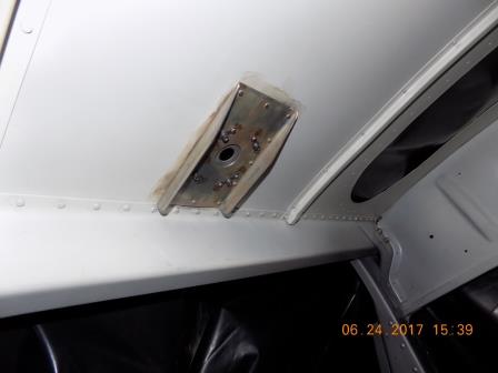

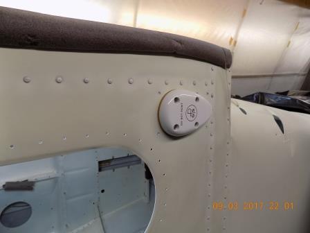

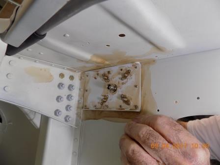

I have two GPS antennas planned for my C140 project. A forward antenna on fuselage centerline for King KLN89B GPS and another Garmin GA 35 at the right rear roof for my Garmin GTX 335 ADS-B out transponder. Garmin recommends at least a 2 ft separation from other antenna to avoid cosite interference, which I was able to achieve with this pattern. Comm antenna is rear left of cabin roof top. Actual measured separations are 36 in between the left rear comm and right rear GPS, both of which are about 30 in from the front centerline GPS. FAA AC 43.13 2-B, para 306 recommends 36 in separation all antennas, but this is difficult to do in a C140 using the limited space in the cabin roof.
- Front GPS KLN89B.JPG (75.33 KiB) Viewed 8866 times
- Right Rear GPS ADS-B.JPG (75.15 KiB) Viewed 8866 times
- Right Rear ADS-B GPS Doubler.JPG (77.15 KiB) Viewed 8866 times

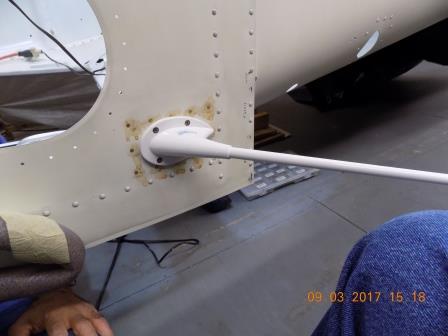

One thing I learned with the nutplates on the doublers to secure the antenna to the cabin roof is to use the Cadmium-plated type rather than the dry film lube type. This is because the antenna grounds are through the mounting screws (manufacturer recommended). The Cadmium-plated nutplates are decent conductors, but the dry film lubricant versions are not. I used Scotch Brite to remove the primer on the inside of my cabin roof and Alodined the area with 1132 Bonderite Pen to make a good ground plane to interface with the Alodined surface of the rectangular aluminum doubler. Bonderite 1132 is considered conductive when applied correctly in the right film thickness per DoD QPL. With this technique, there is no need to remove the paint or primer on the exterior of the cabin roof
- Comant Comm CI-121.JPG (79.44 KiB) Viewed 8865 times
