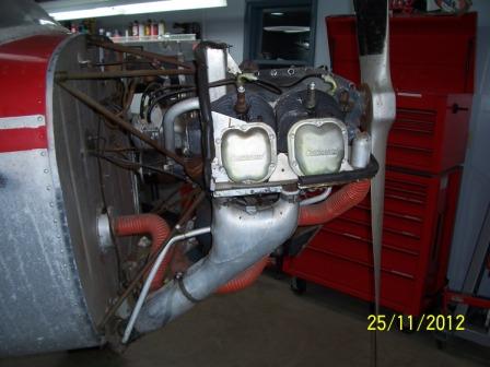

Thought I'd post a few pictures of the project. I began the disassembly this weekend, removing the interior, seats, headliner, etc, and getting access to the inspection panels. The landing gear and mounts are in great shape, apparently owing to a repair done in 1948 "in the Cessna jigs" after what must have been a hard landing, and the fact that the plane did not accumulate many hours after that (only several more hundred). No cracks or corrosion visible.
Then I removed the top plugs on the engine, and put some oil in each cylinder, and pulled the engine though rotation, and it feels very smooth. Other than 1 mag out, it looks ok, with not even any carbon build up on the cylinder tops. The engine logs show 11 hours SMOH, when the plane was stored....

More work today, removed the engine.
Big thanks to Victor for a visit to the shop yesterday and we decided not to try to run the engine until it's been gone thru.

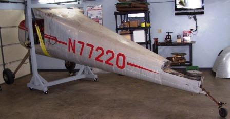

Working to build an adjustable "Sling" to lift the fuse to remove the landing gear for clean-up. Will be able to lower the fuse then for easier access to the cockpit for clean-up and for panel work. Using 4X4's for the sling frame and crank winch's and straps for adjustability. Base is complete, working to finish the rest of the sling frame.
Tail removal is next, then compounding and polishing of aluminum.

Kazoo, that looks like one sweet time machine you've found there. I have a suggestion if I may; The sling plan you've drawn out is, in my view, kinda unnecessarily complicated. I had the engine, wings, gear, empennage, etc, off my fuselage not long ago, and I simply made a plywood saddle for the fuselage to sit on. It was narrow enough to fit between the gear attach slots, and once I had the wheels off, I could take the gear legs off and put them back on without interfering with the stand. I padded the stand, of course, and it fit directly under the gear box, shaped to fit the curvature of the fuselage. I found the fuselage easy to work on at that height, and you can elevate the tail (or not) to suit your needs. Just my two cents, but it might save you some effort.
I think we'll all be looking forward to more progress photos. What a find! Congratulations.
Chris
Kazoo120 » Fri Dec 14, 2012 2:16 pm
Chris thanks for the notes, and I had seen some cradles that guys used but was having trouble figuring out how I would reproduce the curvature of the fuse. I didn't think of making one narrow enough to fit between the struts.
I got the idea for the sling from an airplane mechanic, sitting at a restaurant one night having dinner, who overheard me talking about the plane. I had all the 4X4's needed and the strap and some crank winch's came from Harbor Frieght, I think I really won't have too much time in making this fixture, and it will be able to lift the fuse up to get the struts off, then lower to whatever working height seems to work best.
I have considered that it may also be nesessary to have some sort of cradle though, to stabilize things if they tend to swing, but overall I think the sling won't be too much work to complete, I'll post pix when I'm done, and any regrets if this approach was too stupid.
