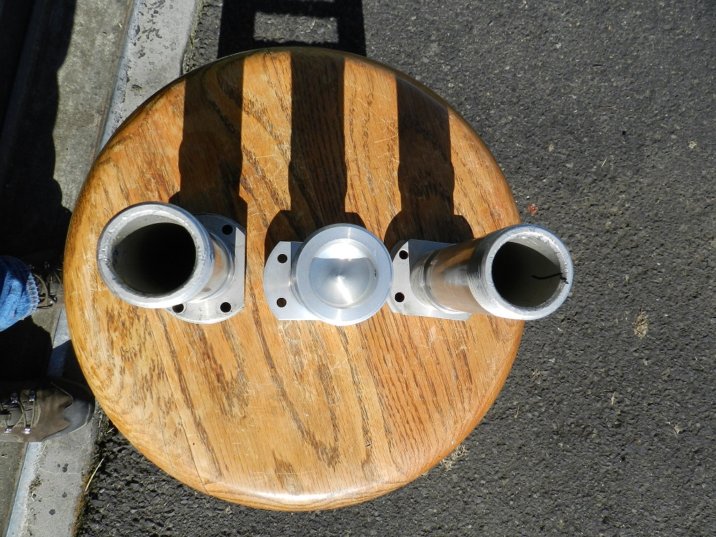

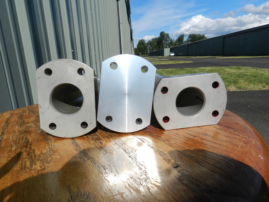

I just put Grove axles on my 140 solid aluminum. There is a thread on here with my approved 337. Make sure you call Grove to order the correct P/N as Spruce doesn't list it.

- DSCN2673.JPG (119.36 KiB) Viewed 18322 times
- DSCN2675.JPG (287.21 KiB) Viewed 18322 times

The aluminum that was used on the early axles, (aircraft s/n 8800 and earlier) 6064?? comes to mind(not sure if that is correct) was discontinued and Cessna went to 2024 T3 which is what Grove uses.
A. I find it very hard to believe a solid axle would not have more strength than a hollow one.
B. You can find steel axles for 170's and 180/185's.
C. Steel certainly would be stronger.
If you can get a field approval for the Groves, by all means that is the way to go.
