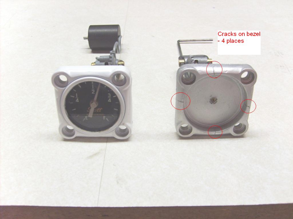

The round Buna-N gasket to seal the gauge against the protruding boss from the tank is available from AC Spruce as Rochester P/N 15-4. See attached drawing. Carefully tighten the 1/4-20 screws in opposite corners to avoid cracking the Scott Gauge housing as happened with one of the gauges that I inherited for my C140 restoration project. Once the gage is cracked, it is prone to leakage.

Photo of one of my cracked fuel gages, which is a common problem I understand because of over tightening the 1/2-20 screws.
