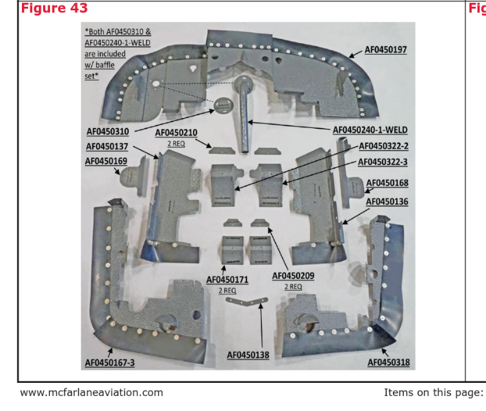

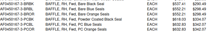

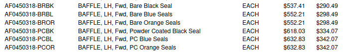

McFarlanes has something....Retail price on left but the discounted price on the right. 2024 price list. Airform is the manufacturer.

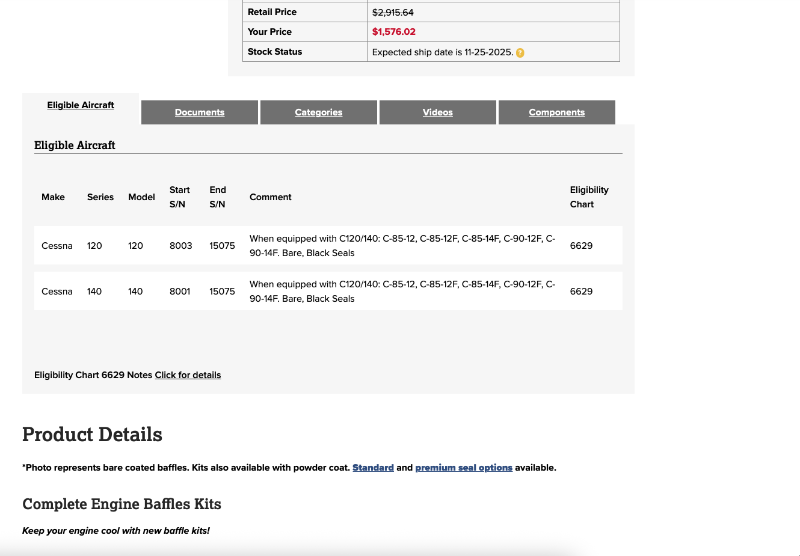

The Macfarlane baffles are made by Airforms. But are they STC or PMA for 140A's? As far as I can tell they are not but I would like to know if I'm wrong?

Here is a screenshot of the eligible aircraft. It doesn't include the 140A.

I'm using a pattern from a Cessna 150 Tim Mix loaned me to make some side baffles but I'm adding/cutting and measuring as I go, I have an 0-200.
I'm trying to figure what the dimensional differences are for the 140A that are different. I know there is a different engine mount that moves things about a half inch or so.
