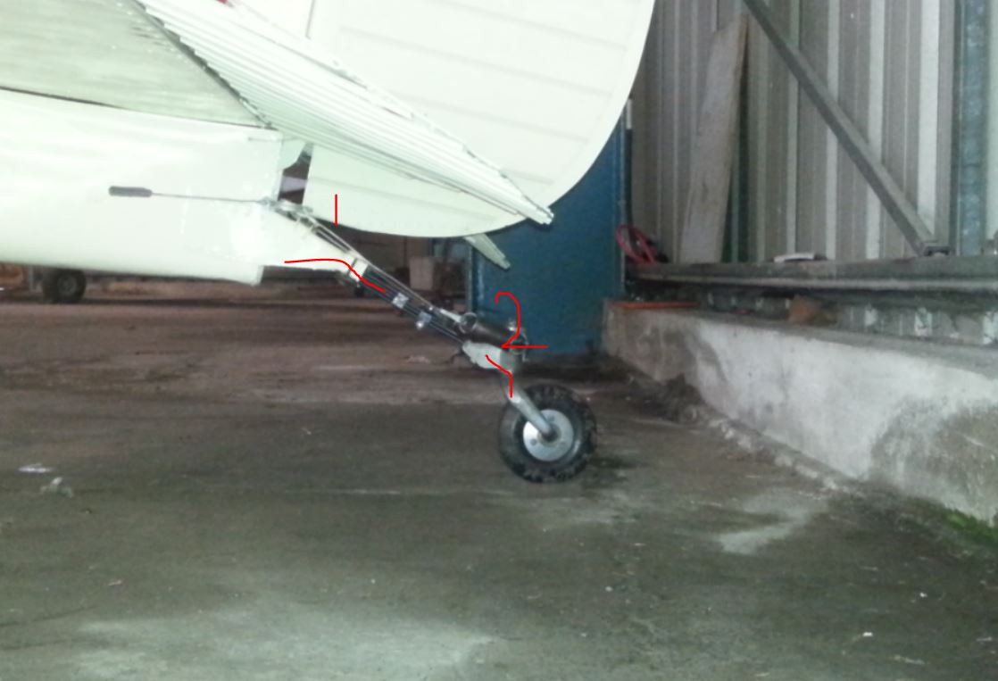

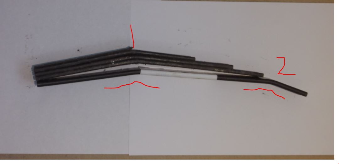

feeling prudent, and planning a visit to Aircraft Spruce next week, I plan purchasing a new (spare) tailwheel leaf-spring.
I have the Lang tailwheel (very similar to Scott 2000 with hard tyre) and need the leaf spring that has the profile of the side view of my existing tailwheel.
I am in the USA at present, so unable to inspect my aircraft, but believe it is the same '2 bend' set as in the other illustration.
Can anyone confirm the spring type needed for my aircraft (as seen in the aircraft tail side view) and is it the same '2 bend' as the illustration of the leaf set shown and, if so, what is the correct p/n !
hope this all makes sense
thanks
Graham

- side view of set - is this same as I have on plane at present ?
- Capture tailwheel 2.JPG (35.89 KiB) Viewed 10260 times
- side view of existing tailwheel - are there bends at position #1 and #2 ?
- Capture tailwheel 1.JPG (77.79 KiB) Viewed 10260 times

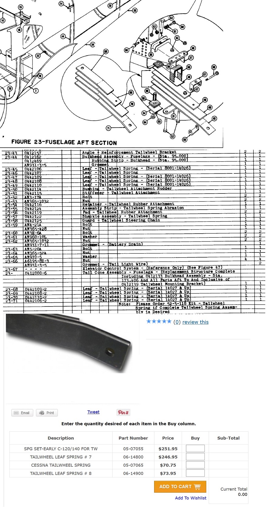

Graham,
The 'single bend' and 'double bend' options are based on serial numbers. See attached. A little hard to tell which you have on your bird.
I had a 'double bend' spring set on my early serial# bird and the back end was way too high.
With that said, the Aircraft Spruce catalog is very vague on which springs they have as far as Cessna parts numbers are concerned.
- Untitled.jpg (504.6 KiB) Viewed 10256 times

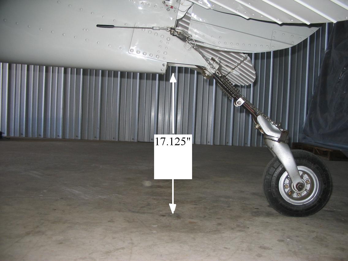

- Posts: 568
Re: Leaf spring p/n
My 'double bend' spring set on my early serial# bird...
My correct 'single bend' spring set on my early serial# bird....

Re: Leaf spring p/n
I ordered 05-07055 for my 1946 sn:9168 and it is the good match for the Scott 3200. As per 6597 second picture we can see that Scott table is parallel to ground, which is the best setup.

- Posts: 2810
Re: Leaf spring p/n
Aircraft Spruce resells Univair springs. I believe the Univair part numbers mirror the Cessna numbers, with a "U" in front.
