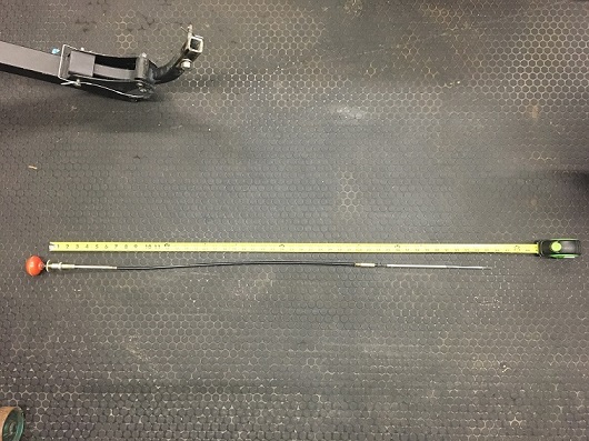

I'm also interested in replacing my Throttle Cable. Here are a few pictures of the assembly that is currently in the airplane. Do you think the McFarlane part is a drop in replacement?
Thanks,
Thanks,
- Overall Length = 45.5625"
- IMG_6126.JPG (108.23 KiB) Viewed 8955 times

6298
- Posts: 248
- Name: Randy Thompson
- Location: California
Re: Throttle and carb heat cables
Looks like the same one I took out. The one I installed fit fine. Another friend at the same airport replaced his with that part and it was just right.

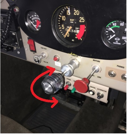

Today we installed a McFarlane Throttle cable in the 120. It fit perfectly, and is much smoother than the old cable.
It seems to have one curious feature. The knob and shaft can be rotated freely when the friction lock is loose (the jam nut is tight). Is this correct? The old one did not rotate in this way.
I'm planning to give McFarlane a call on Monday, but I wondered if anyone else made this observation?
Thanks for any help!
