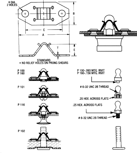

Has anyone changed the door catches to anything besides the little metal tabs that just seem to be making the hole in the door bigger every time you use it?

The metal tabs on the struts are supposed to fit into a metal "clutch" that is riveted to the door panel behind the holes in the door. Not a good system, but it's what we have. I have some spare metal "clutches" if you need some.
