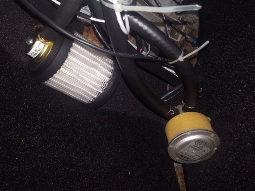

My regulator/filter is on the interior side of firewall upper pilot's side. Will try to get a pic.

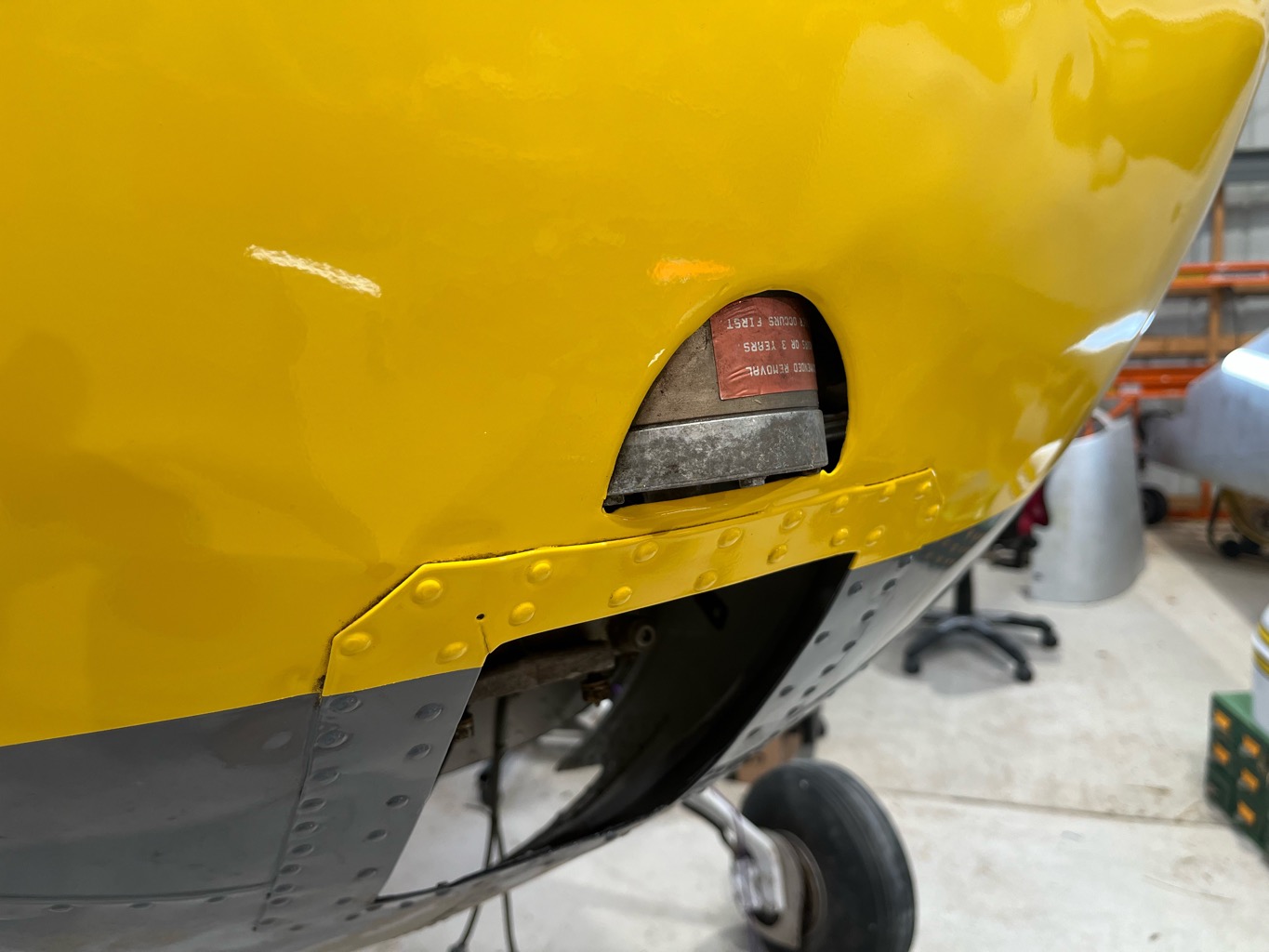

Does your cowling have the 'wart' for the vacuum pump? The lower cowl won't fit over the pump unless you modify it, at least that was what the previous owner did on my bird.

See great idea. Mine has a cutout so the pump protrudes out the front. I like the cover over it. Will modify mine to resemble yours. I will get a pic up tomorrow.

Mine sticks out. Not a fan of the look. If you all have a firewall shot of your vacuum regulator and filter location for a reference would be great.
- IMG_8347.jpeg (181.99 KiB) Viewed 4260 times

Here's my system guts in the interior, part on the inside firewall and part on the left fuselage inside.
