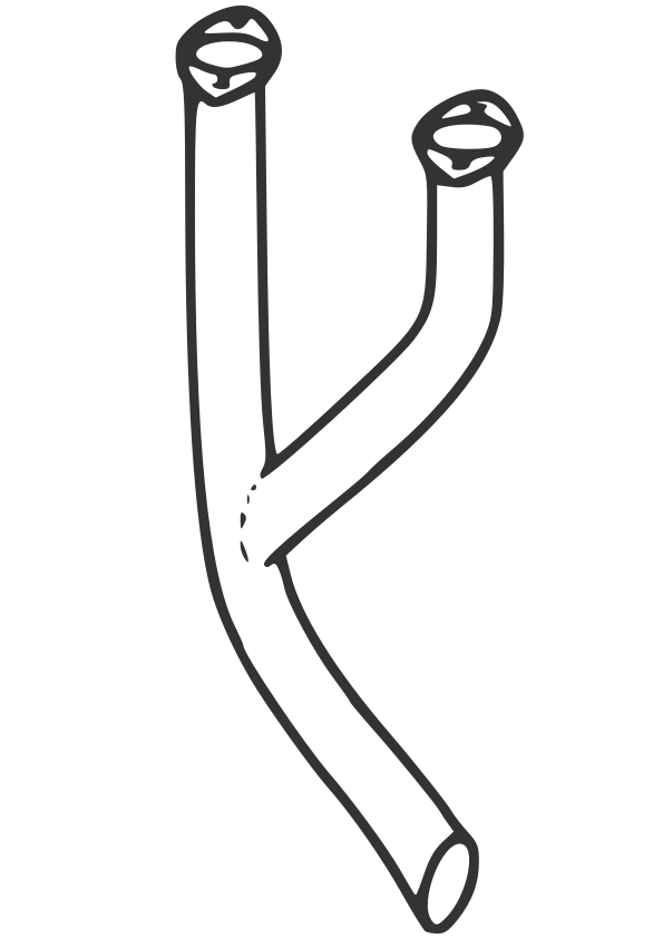

I was told I have to inspect the exhaust every 25 hours. I have the straight stacks. From my reading of AD 48-25-02, it only applies to "those aircraft equipped with exhaust muffler assemblies that are fabricated by welding exhaust stacks to muffler." Since I don't have mufflers, I believe the AD does not apply. Is this the generally recognized interpretation around the organization?

- stack-lh-0450145-1_5.png (48.74 KiB) Viewed 1959 times

You are correct. It only applies to what are "affectionately" known as "pancake mufflers".
