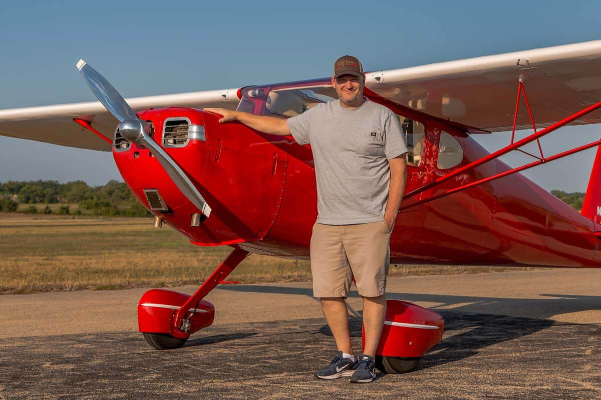

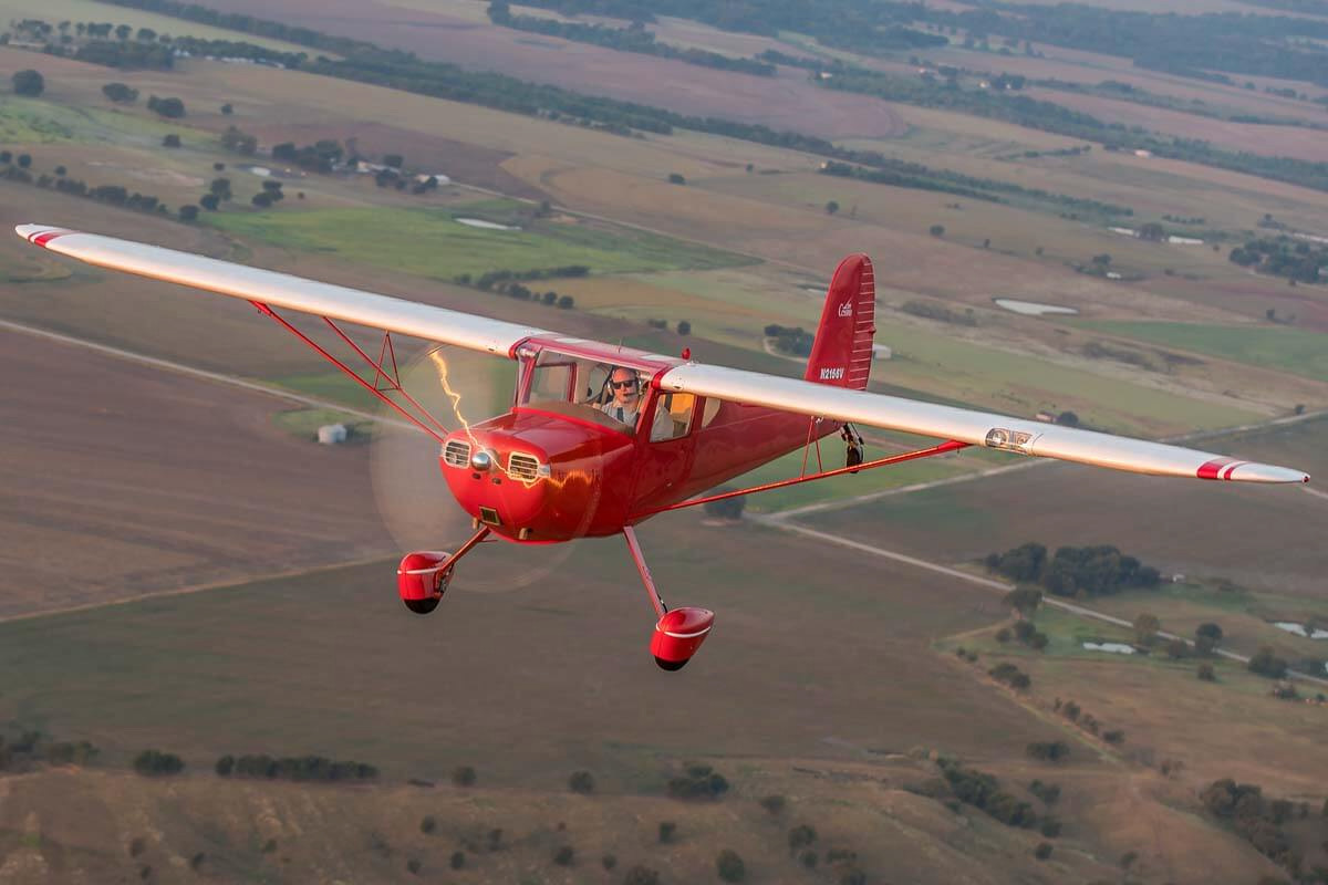

I did some more hunting around and found an article written by the owner shown in these photos, who says he is 6'2" which is my height, but 240 lbs (so significantly broader than I). He loves his 140. He mentions taking an 8-hour XC flight in it, which is similar to the trip to Alpine I'm looking at taking regularly to see my father (though that's driving time), and he said he was actually comfortable.
The second shot of him flying looks like he's hunched over, but I'm guessing that's him leaning forward to look up through the windshield for the photo...? The final image of the cockpit shows headroom that, frankly, looks ample--though I guess the scale of the seats, etc., could be deceiving...
