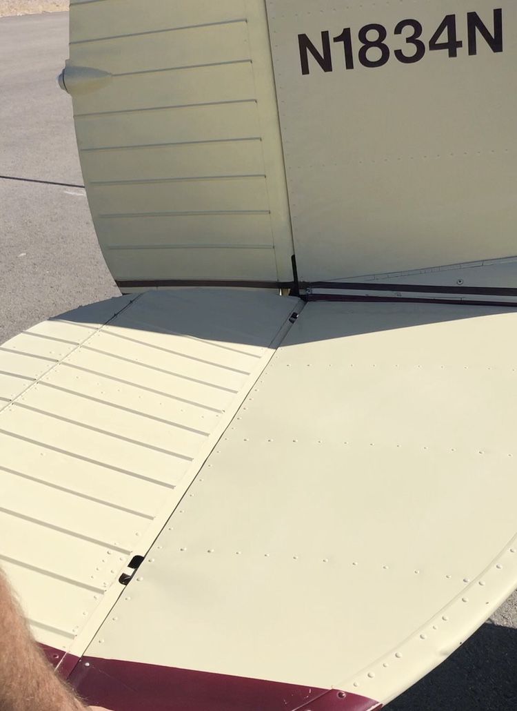

Went back to take another look at the stabilizer canting problem. The owner and I removed the fairing between the vertical and horizontal stabilizer which revealed the top section of the horizontal stabilizer. This is the section that produces the oil can sound. No cracks, fractures, loose or broken rivets. I think the “00432160 reinforcement will solve this problem. Where does it go, would you have a picture and where can I get one?

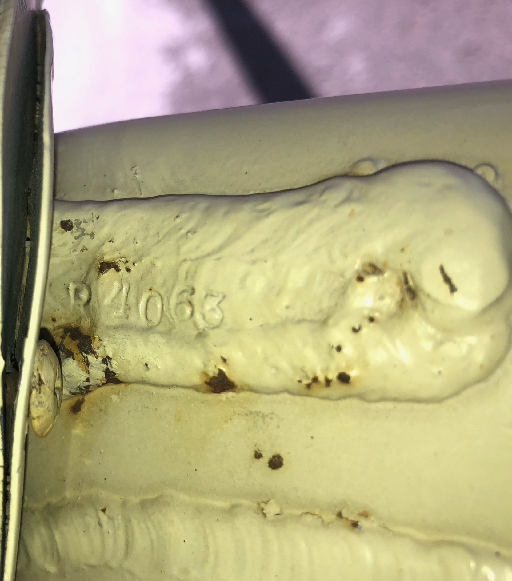

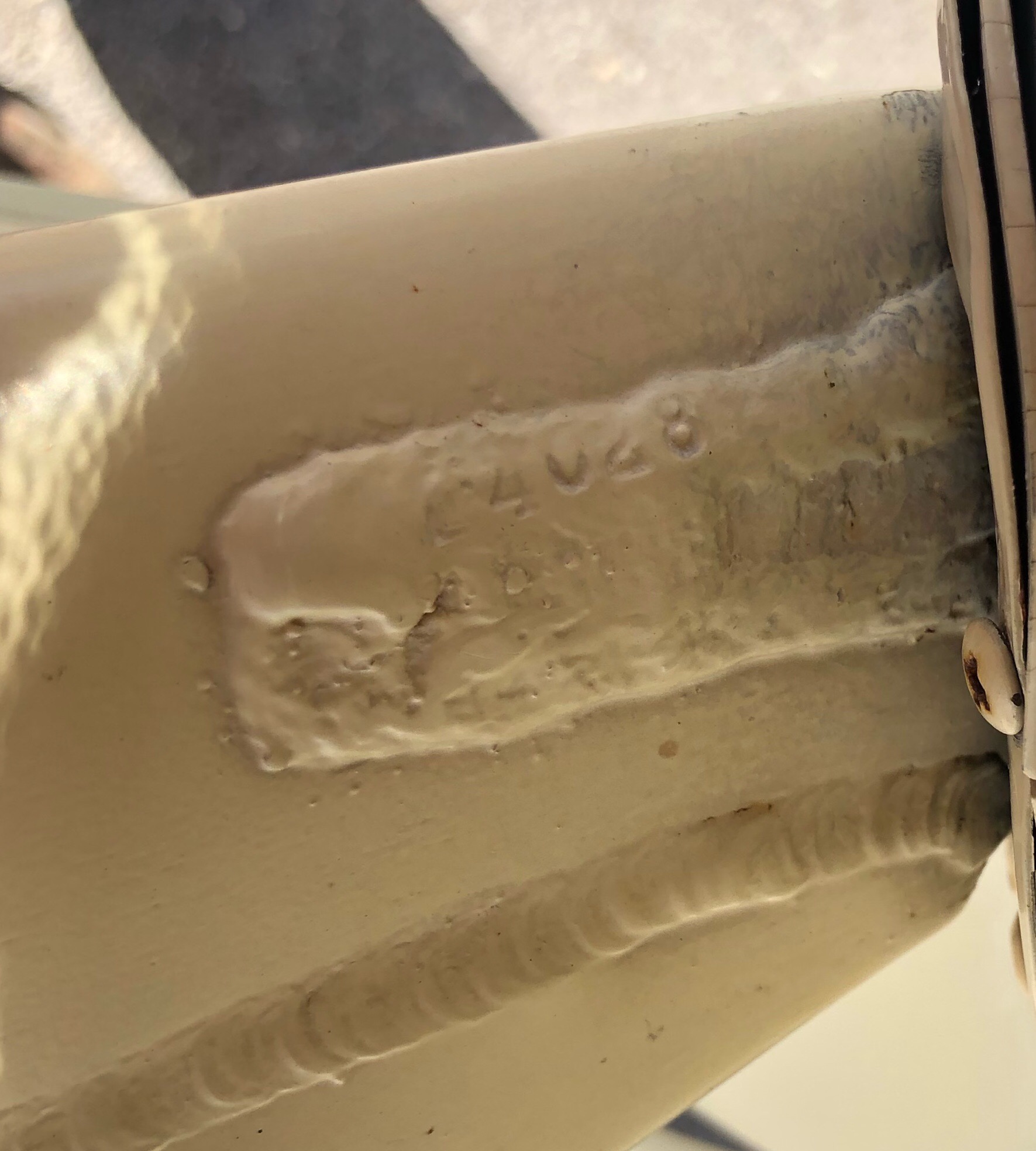

Also took a another look at the struts stamped numbers at the base. The pictures aren’t the best but you can see a “R & L” stamped on the weld. The “L” is a little tough to see but I’m sure that’s what it is. The A&P is still not convinced about the tension of the rear spare and even went further saying it (left rear spar) had excessive vibration when the engine is at idle. This is new to me since he didn’t point this information out earlier and I didn’t see it. Any comments here?

Re: Rear strut condition
Your IA should have a borescope to see if the stab reinforcements are already there, it's a ton of work to install them so make sure you don't already have them. I think I got mine from Univair years ago. See my previous pic as to their orientation. I'm going to presume your IA has gone thru all the Service letters and AD's regarding the tailfeathers and all check out (see Resources tab on main website page). My stab rebuild by Tim Mix in Oregon worked well for me.
I would have some experienced eyes look at the canning to see if it really is an issue.

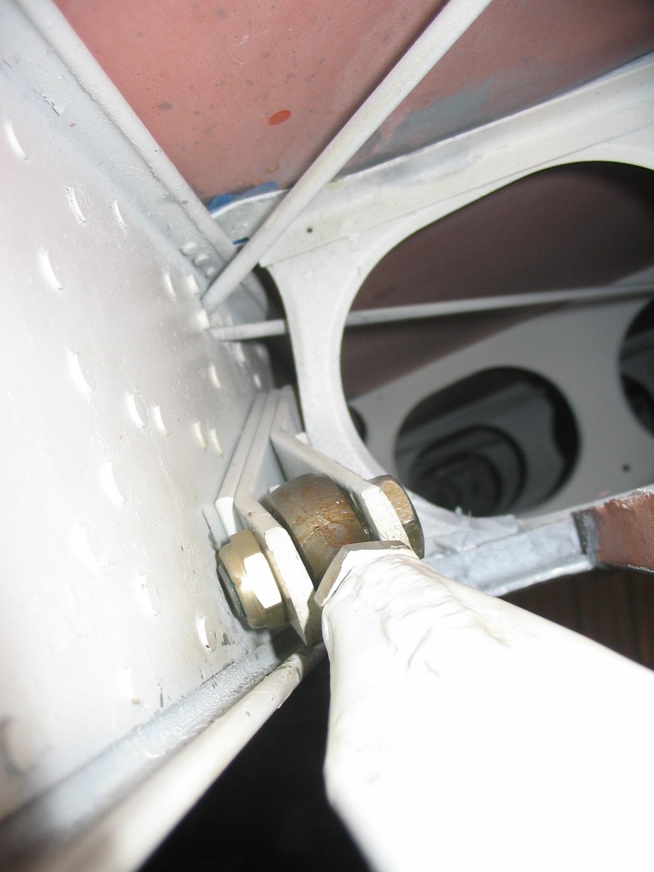

Good news about having the correct struts. Can't help much on the rear strut, here's what my fabric wing connection looks like on the left side. Does he hear a drag wire vibrating? Much discussion on whether they were left in or out on various metalizations.

- Posts: 2775
The lift struts are not under any tension while the plane is sitting stationary on the ground, in fact, they are under compression (so there won't be any tension.) The jury struts help the lift struts support that compression loading.
I must admit I’m a little jealous on the condition of the spare and ribs photo. Very nice!

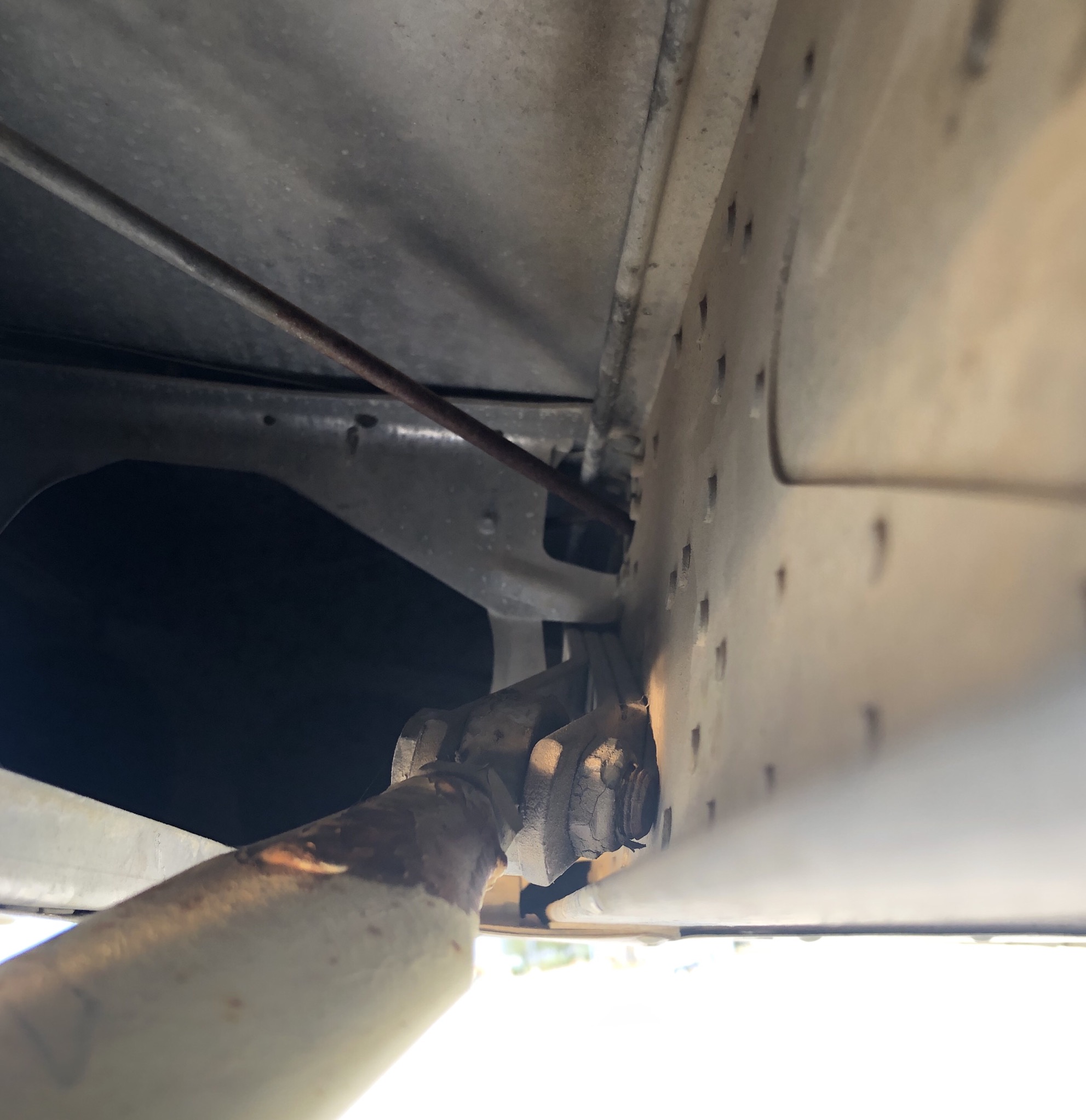

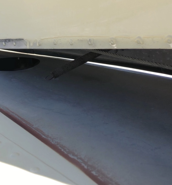

Sorry I didn’t pick up on photo of the reinforcement pieces earlier. I was looking at the wing they were sitting on instead of the pieces. Attached is a partial shot my empennage. I think the leading edge reinforcement is incorporated in my tail surface.
This is all really great information which just confirms I need a new A&P. He’s good but he just isn’t familiar with old airplanes. I think the last straw was when he told me I needed to rebuild my Stromberg carburetor. With the mixture control pulled back/ off, it didn’t shut off the engine and he didn’t like that either. It’s just the way things were done back in the day.
