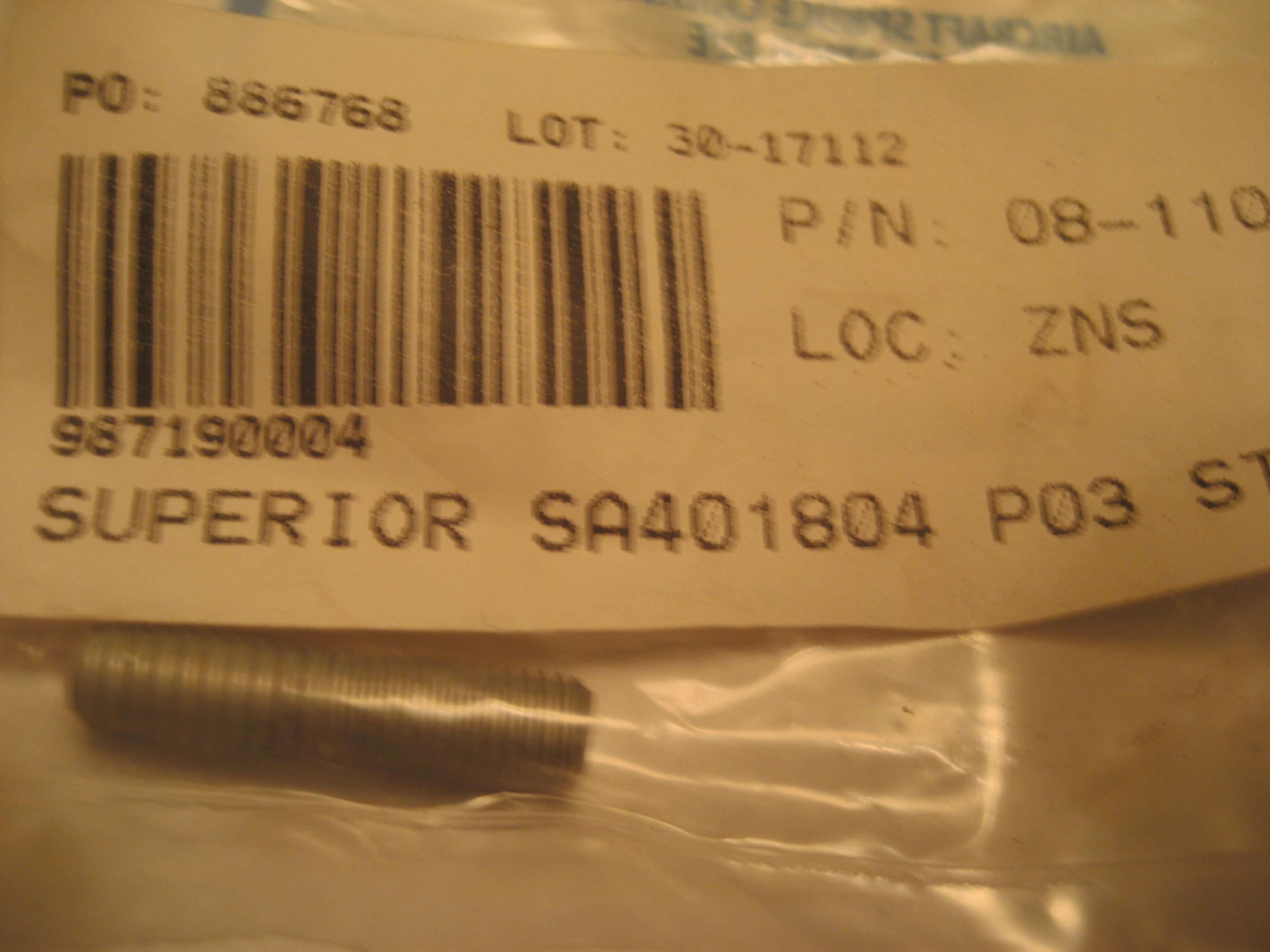

Here's the current stud:

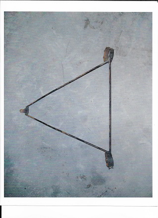

...and, here's a pic of the bracket. It'll fit to the rearmost stud.
EXHAUST BRACKET RESIZE 3.jpg (46.54 KiB) Viewed 3833 times

Those are the nuts that I used to mount the oil tank to my accessory case. I also had one stud that was loose in the accessory case and was leaking oil. There are studs available with the coarse threads oversized to prevent leaks. If I recall, they are color coded to indicate the amount that they were oversized. A dab of gas resistant grease also helps with preventing leaks past the studs.

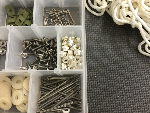

The MS nuts John uses are I believe the high temp nuts you see holding turbine engine hot sections together, their silver color comes from them actually being silver plated for high heat resistance, they are a strong nut and really not expensive, and are pretty corrosion resistant as well.
This is a pic of them, these are only 10/32 and not 1/4” but otherwise pretty much the same.
If I can’t get the stud out by screwing two nuts together I’m not going to remove it. That method gives you plenty of torque to bust a stud, and I’ve seen too many busted magnesium cases in my career. Airplane is 77 yrs old, one assume at some time in its life it had the correct exhaust brace on, so there must be a way
I got the Wag Aero brace in yesterday, the tab measures 62 thou thick, a thick washer is 60 thou, so it ought to work. I have cotter pins in my studs now, some studs required a thin washer 30 thou and some a thick, 60 thou, I assume due to being set at different depths and not different stud lengths?
