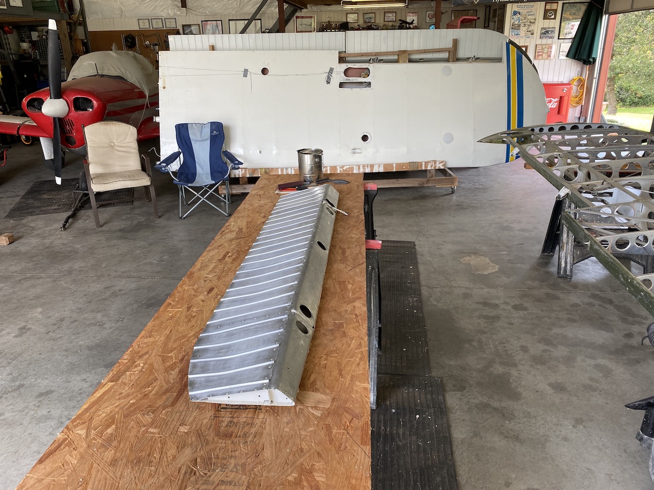

Had to work on the Cherokee today to help finish up the annual, but I wanted to post an update.

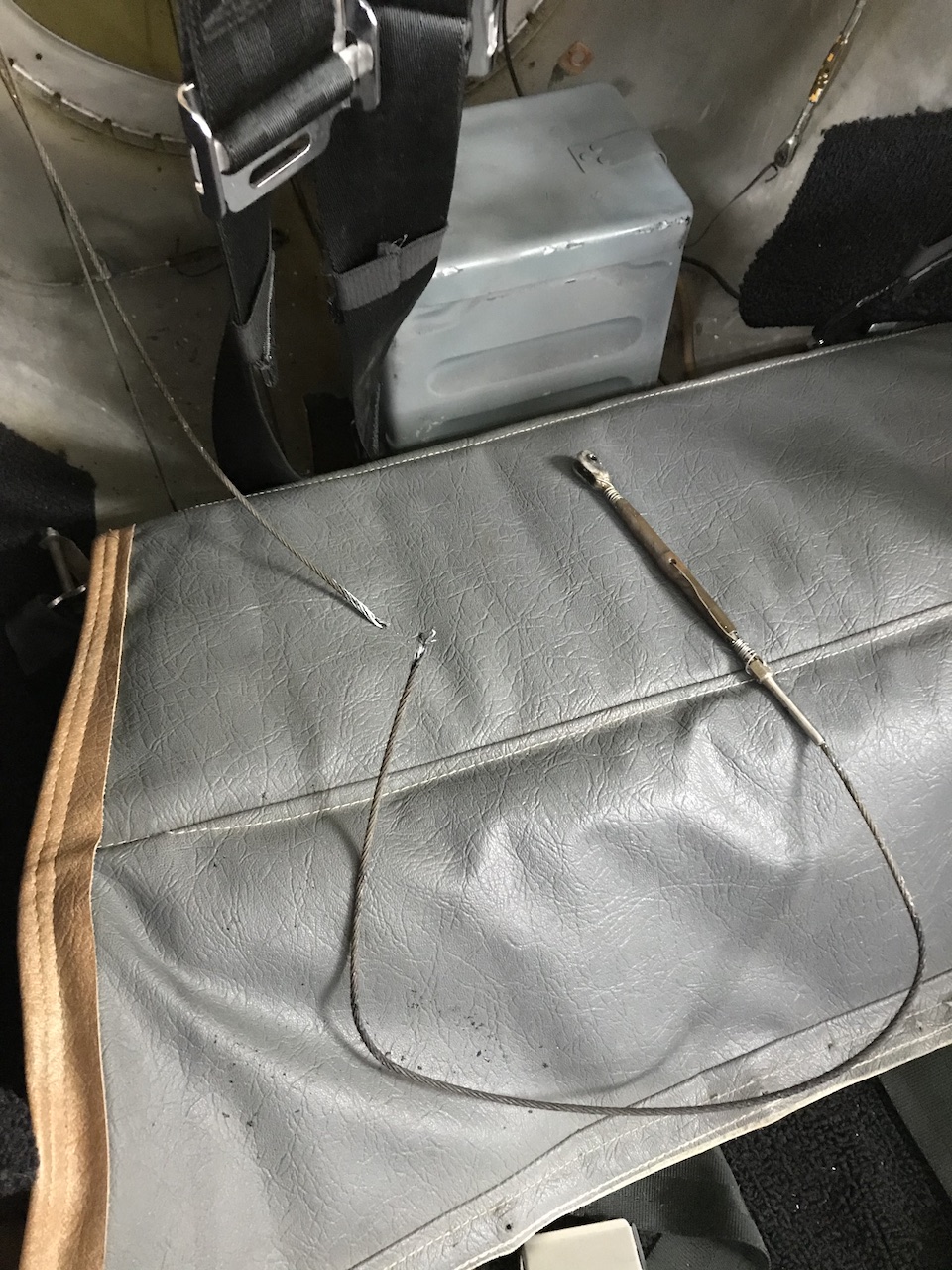

7 Aug 2020 - Had a minor setback last week when an aileron cable got caught in the buffer. Matt had been watching them closely throughout but in one particular tricky area around the wing roots, the buffer slipped, grabbed the coiled and taped cable and pulled enough tension on it to somehow connect to the positive cable running from the battery box. POW! Fried and separated cable. No other damage was done fortunately. One of the A&Ps helping us said to leave the cable as is and it can be used to thread the new one into the proper channels. Fortunately, the cables can be found for around $50.

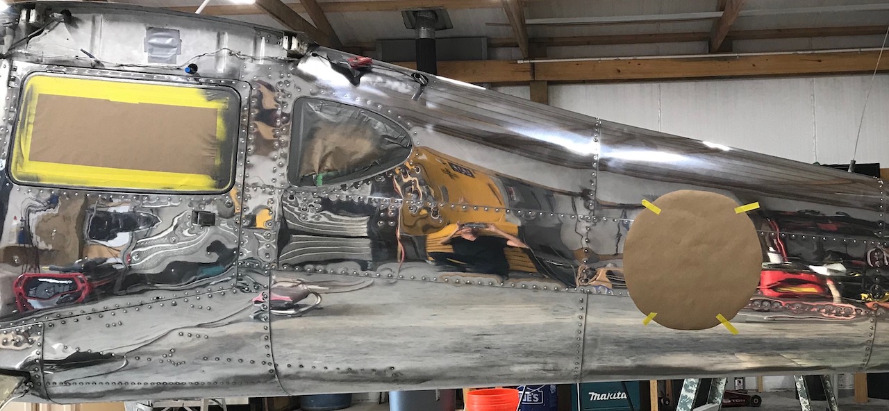

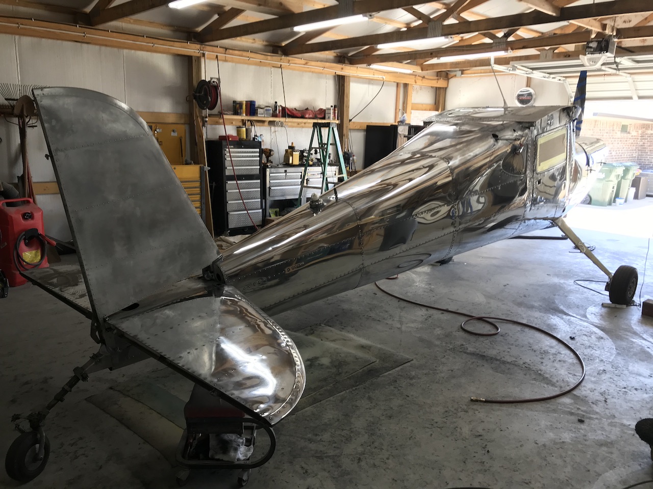

Other than that, the left wing control surfaces are now completely stripped along with the rudder. Next is the right wing control surfaces and then the wings will be ready for covering. Also plan on stripping the elevators so all the control surfaces can be buffed together. I have found that the Jasco product takes care of the paint fine. A second coat gets alot of the primer and then the heat gun loosens the rest. Slow go but it works.
Fuselage is nearly buffed out now, with only the tail fin and top remaining.

8455
Posts: 30
Joined: Sat Apr 27, 2019 1:05 am
Aircraft Type: C140 / O-290
Post by 8455 »
Thanks for the update - I've enjoyed reading your journey.
I love the look of the polished fuselage!

Any advice on threading the new cable to replace the old?

Use the old cable to pull the new one through.
Years ago I modified a turnbuckle to be able to pull a new throttle cable on a Cessna 421.

8342 wrote: ↑Wed Aug 19, 2020 9:16 am Use the old cable to pull the new one through.
Any opinions on using salvaged cables vs new? Steve

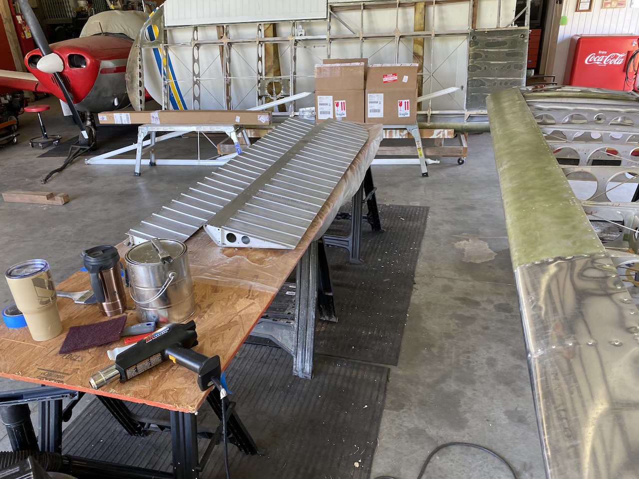

21 Aug 2020 - Steady slog today with the right aileron stripped. Lots of heat gun work to get the final bits but it comes off.
