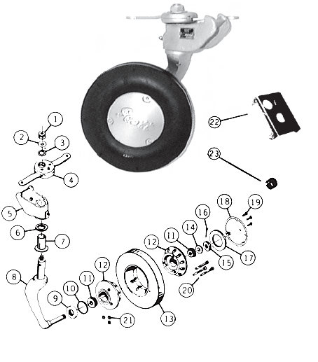

In case you were looking for info about servicing your 2000 tailwheel.....
viewtopic.php?f=10&t=147
viewtopic.php?f=10&t=134
https://www.aircraftspruce.com/catalog/ ... kkey=22510
- AirAssociatesCatalog.pdf
- (330.72 KiB) Downloaded 1047 times
- scottModel2000.gif (42.09 KiB) Viewed 6346 times
