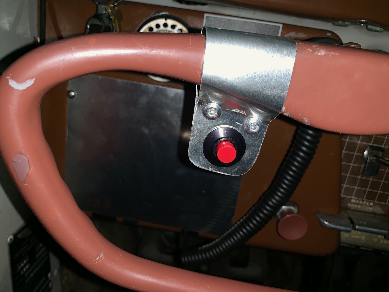

8474
Posts: 313
Location: Saskatchewan
Aircraft Type: C140A
Re: Push To Talk button location
Post by 8474 »
Will tidy this up a bit when the airplane gets its new interior, but for now it works well.

8474 wrote: ↑Wed Aug 14, 2019 12:42 pm Will tidy this up a bit when the airplane gets its new interior, but for now it works well.
Mine is similar to this except flat metal screwed to back of yoke not wrapped around.
