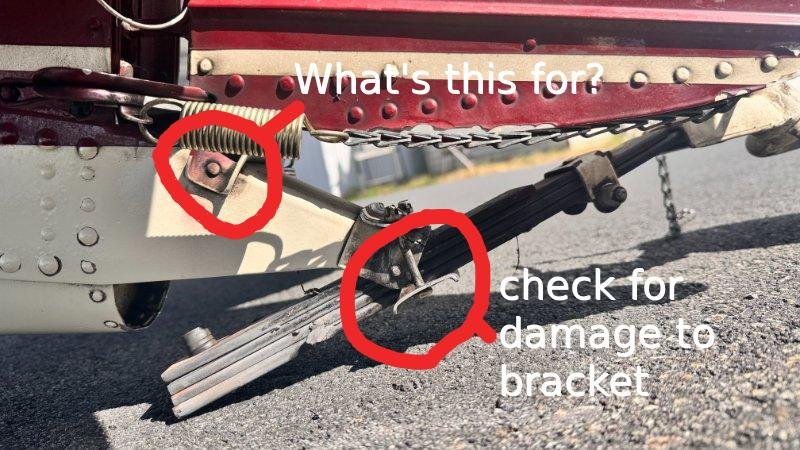

Looking for all the parts required to swap from a maule tailwheel to a Scott 3200. We just had our leafspring on our maule tailwheel collapse on landing so I'm thinking this is a good time to make the switch. I've included screenshots of what's in the cart now.

Looks like there's a few parts missing where the bolt holds the front of the springs to the tail wheel bracket. Check the Neal Wright article for details.

I wonder why the official Scott install says AN7-20 (a drilled bolt) but also says to use the 365 self locking nut....
I'm guessing the nut that holds the spring stack together in the front finally gave up the ghost. I check that on every pre-flight. Don't ask me why......

I would use a -20A bolt.

I use and undrilled -20A and a metal locking nut AN363-720
Scott tension springs used on your Maule?
What is that mounting angle piece for that I circled.
Check for cracks on your tailwheel bracket where the springs pivoted.

The "what is this for" is the bracket the bolt passes through.

Good grief, senior moment on my part...The "what is this for" is the bracket the bolt passes through.
