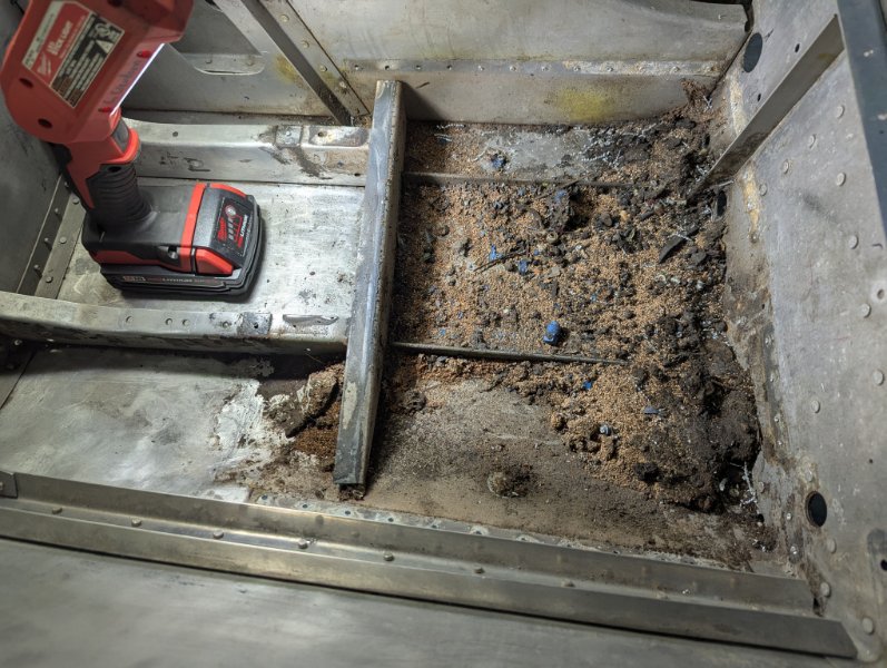

I got those floorboards out and there was SO MUCH gunk under them.
- PXL_20250906_194402015.jpg (224.84 KiB) Viewed 176 times
