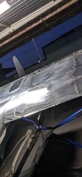

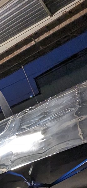

Dave, my apologies. Forgot, then got busy, haven't been to the hangar in a while. Im trying to visualize what you are describing. Ive never had the tank cover off in the few years Ive owned it. Cover does slide under inboard panel but confirming whether it is then riveted to the rib I think would require some disassembly?
Does this image help? All PK screws securing the cover

Dan,
Wow! your plane looks great! I don't think you can see anything by removing the fairing. If their were rivets, unless they were flush rivets, you'd see the cabin skin sit off the surface of the wing by the height of the rivet heads. I don't see that in your pictures so I'm thinking it's not riveted. I'm thinking more and more about using machine screws but still haven't convinced myself cutting the threads won't cause spar cracks down the road.
I appreciate your sending the pictures.
Dave
