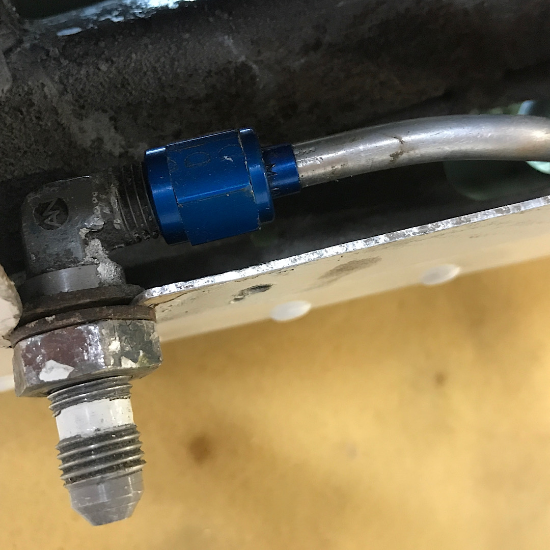

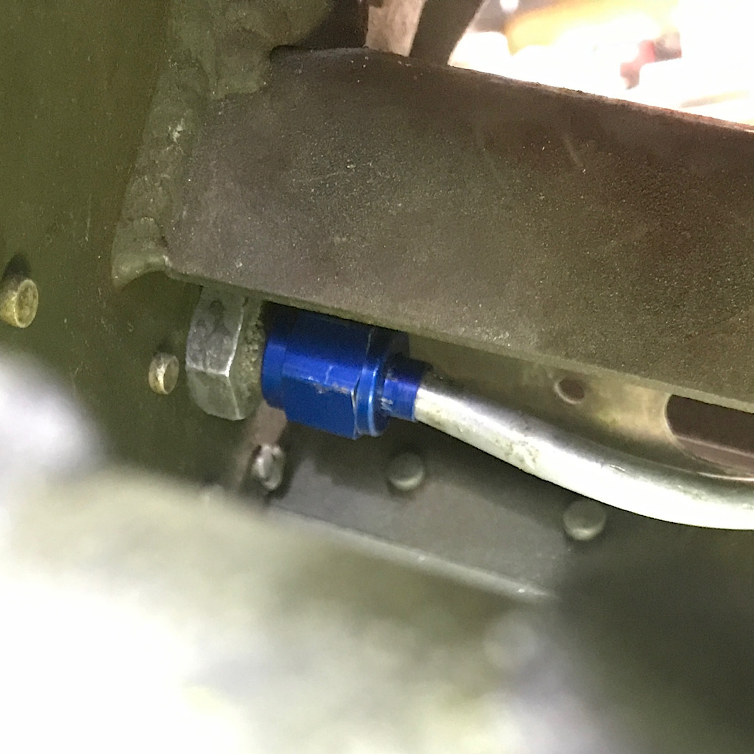

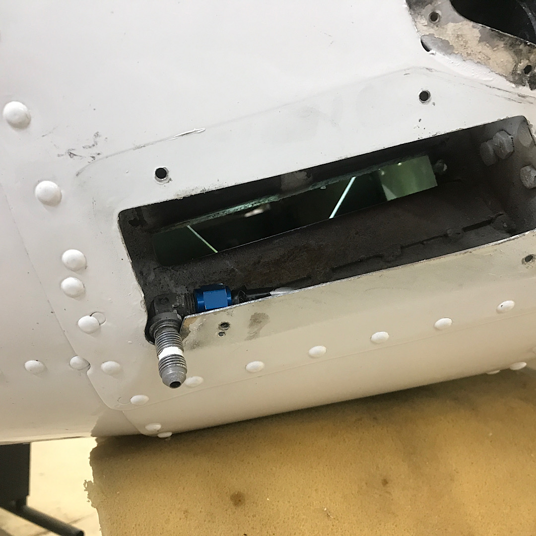

Thank you for the advice. I ordered hardline tubing and new fittings bent and flared to fit. I do have to say this was challenging but rewarding. Posted some pics. Thanks for all the help I get from this forum. One day this will fly again…
