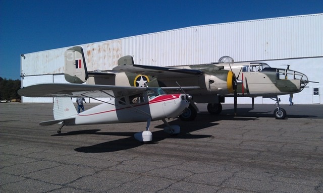

Re: WANTED - Pants Mounting Plates
No, I put them on 12 years ago and haven’t removed them since. I believe they don’t remove easily?
- F09DC7F8-0D69-45D9-A5E5-BD0EF70DC0FC.jpeg (80.03 KiB) Viewed 5654 times

Depends on how much work you thing R&Ring the axles is, I guess!
