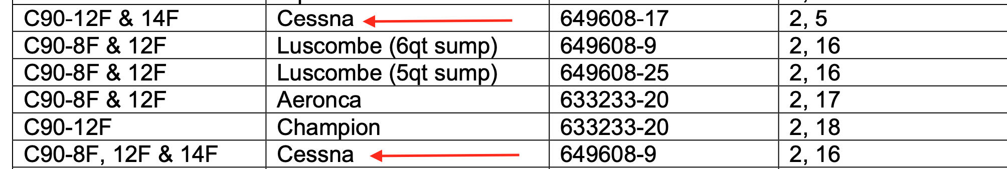

6643 wrote: ↑Mon Nov 18, 2019 7:07 am
8233 wrote: ↑Sun Nov 17, 2019 5:16 pmI don't see an oil sump listed in the 120/140 IPC and the sump I have is approved per the Continental IPC for a C-90. What's the basis for stating that tank is not allowed?
I guess I should have said "In my opinion..." The Continental IPC says "To obtain correct replacement oil sump, order same part number stamped on upper surface of original sump mount flange. Also, give engine application." Also, Continental Service Information Letter SIL 00-7A lists only one dip stick applicable to C90's in any Cessna, including the 140A, and it fits the 5 quart tank. (Interestingly, they list two for the C85, one for the 5 quart tank and one for the 6 quart tank, but no mention of specific aircraft models.)
Another curiosity: they also list an O-200A Cessna application with a 5 quart tank...
Bottom line, there doesn't appear to be anything that allows up-sizing to the 6 quart tank, so, going by FAA precedence, if it's not specifically allowed, then it's not allowed...
Thanks John, it's always interesting going down these rabbit holes. I do see 2 different sumps for the C90 when I search for SIL 00-7A. One of the 2 references the 6 quart sump if I am reading the foot notes correctly.
David Freeland - CFII
Posts: 2811
Re: WTB: Oil Tank Baffle and oval plugs
8233 wrote: ↑Mon Nov 18, 2019 8:19 amI do see 2 different sumps for the C90 when I search for SIL 00-7A. One of the 2 references the 6 quart sump if I am reading the foot notes correctly.
Yeah, if you have a C85, an O200 or a Luscombe... ;)
Screen Shot 2019-11-18 at 9.38.05 AM.png (105 KiB) Viewed 5945 times
