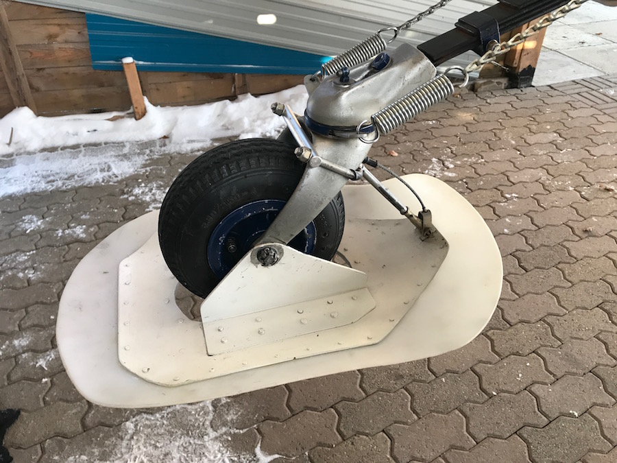

I spent a complete winter without a tailski and went into all kind of snow. Not the best scenario, but it works. On takeoff you find/feel the point where the wheel is just above snow. This is just enough to put not too much pressure on the main and remove drag from the TW in the snow and gain speed.
To be honest, while we have certified Federal skis on the main, I have never seen a certified tailwheel ski so far on any light planes like the C140 category. We all have fabricated ours. It is a penetrating TW ski that attach directly to the TW fork.
Ho and before JohnC tells me that I have the wrong tension springs on my Scott 3200, I wanted to say that I have changed for the good type spring since that picture was taken
- IMG_3023.jpg (207.21 KiB) Viewed 6717 times

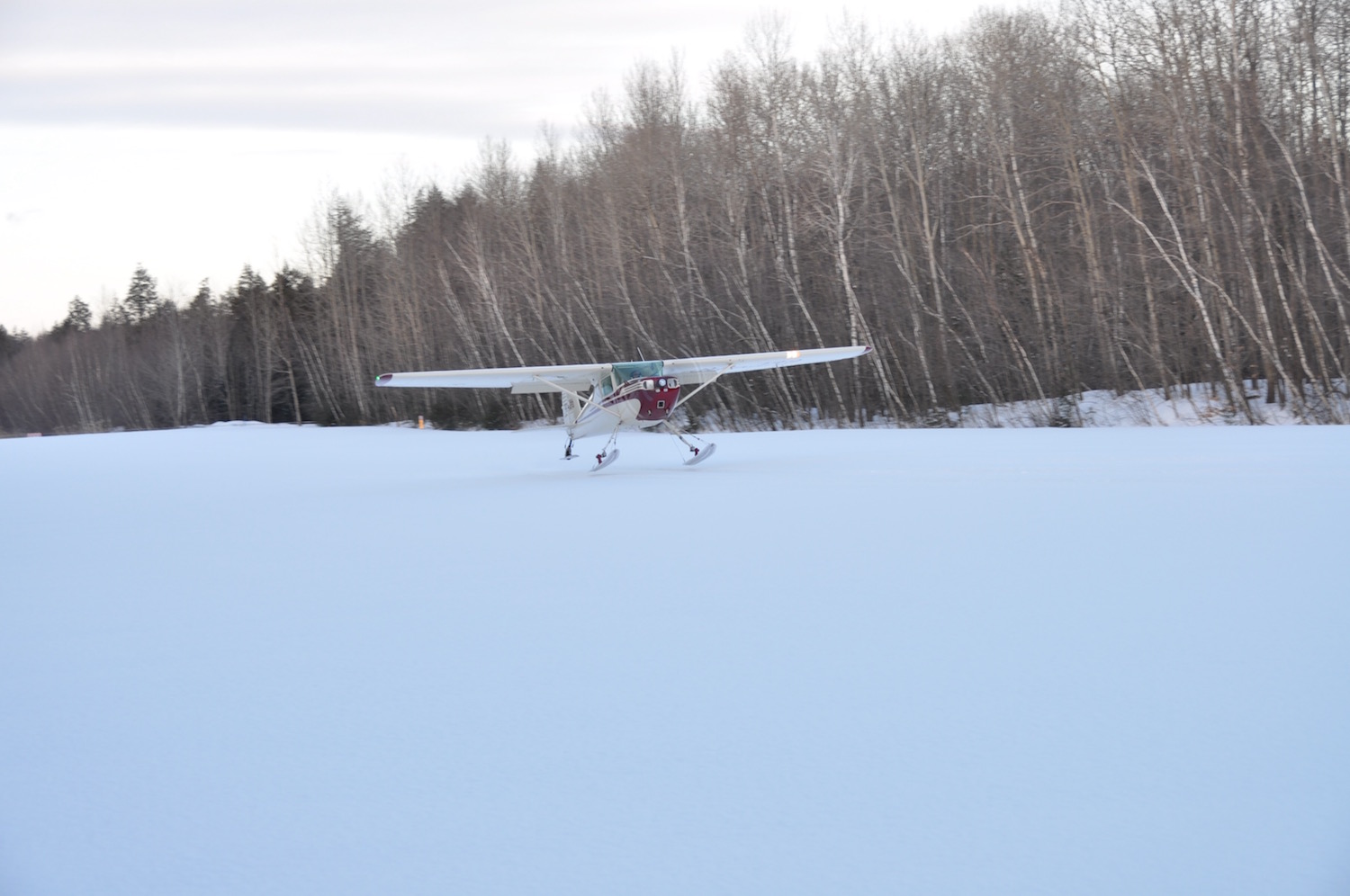

More pictures, My friend's Paul 140A completely restored
Enjoy, If you have more questions let me know.
- DSC_5242.jpg (229.1 KiB) Viewed 6717 times

That looks so fun!!
