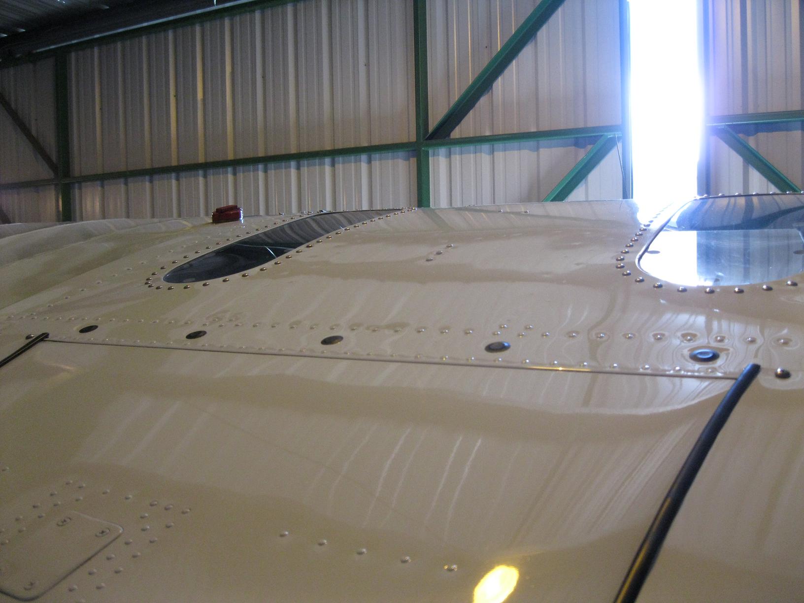

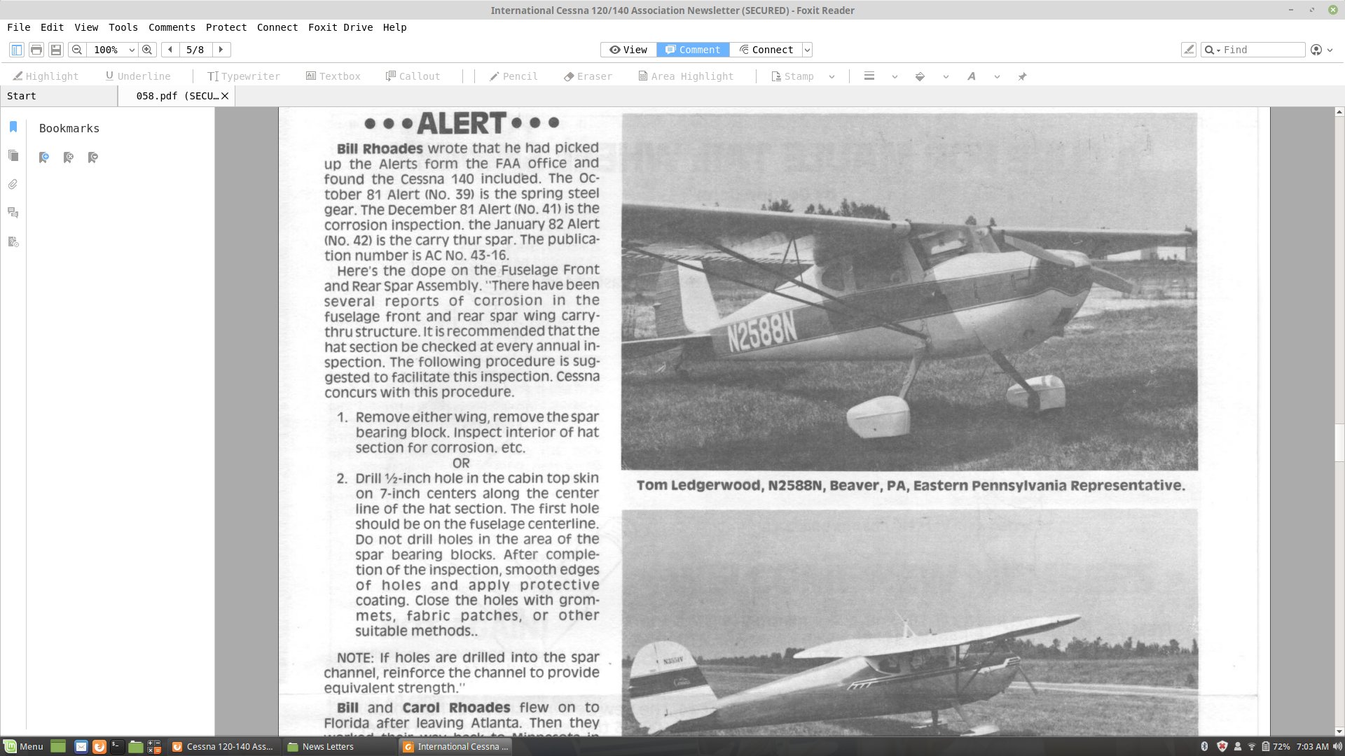

I have the same inspection holes fore and aft, here's an attachment from a 1982 Association newsletter. I think the Luscombes had something similar at one point. I replace the plastic plugs every two years after I shoot the insides with ACF-50 with an atomizer. I'll see if I can find some more info...

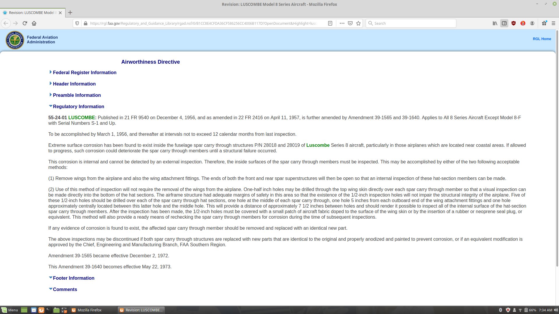

And here's the Luscombe AD that started it all....
