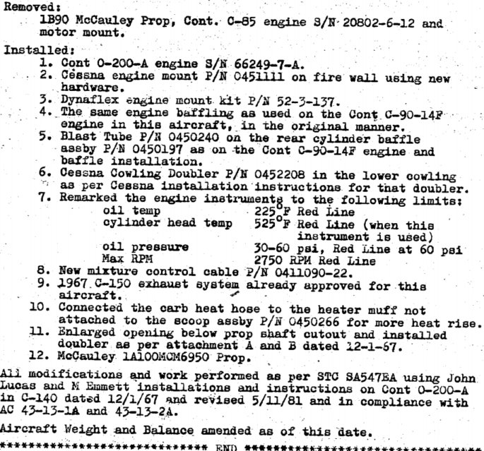

My STC from Randy Thompson shows this:
Installation Instructions (STC SA547EA)
6. Remark the engine instruments to the following limits:
Oil Temp 225 degree F. Red Line
The STC that's in your aircraft paperwork should have the correct instrument markings information.
The 225 degree red line is the same on the oil temperature gauge in the C150D that my engine came out of.

Re: O-200 Oil Temp Red Line
The old 0-200 STC on my bird has a similar requirement for 225F
That being said the TC does have a notation for the higher temp. I believe the STC rules....

Steve and David, thanks to you both. I hadn't considered checking the O-200 STC, but I will. The 225 red line on my temp gauge now makes sense assuming that's the case.
And to Steve, by coincidence all this started for me when I noticed my friend's C-150 had its original Cessna oil temp gauge that was red lined at 240. I guess 225 is too hot, except when it's not...
