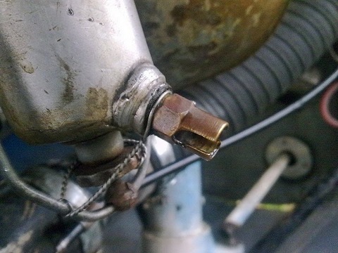

MS29513 should be OK as long as there is no alcohol in the fuel.
If the drain valve is a Curtis valve, it is not rebuildable. The seal is not an o-ring; it is a flat washer, and the valve is known not to last through the second seal. When it fails all the fuel comes out.
Curtis drain failure.jpg (58.04 KiB) Viewed 2971 times
