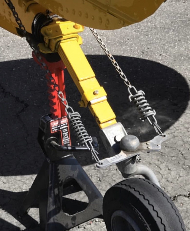

She has really good bones but she is no show queen. There are some parts i want to change even though the annual was done a month ago but have a few questions. The tailwheel chain and springs are rusty so its the first change coming. The chains are extremely tight with the tailwheel on the ground. I have flown some cubs and remember there being a little slack in the chains. Anybody have any reccomendations on if they should be tight or have a little slack with the tail on the ground.

I ran out to the airport real quick, as you can see the previous owner let her sit outside for quite a bit

Posted: Wed Dec 11, 2019 10:10 pm
Upside down, too!
That's a Scott 2000. The chains have to be tight, 25# tension, IIRC, or it won't steer.
Here's what you need: https://www.univair.com/tires-wheels-br ... -assembly/

Awesome! i would have never known it was a scott 2000! i apreciate the link very much!
