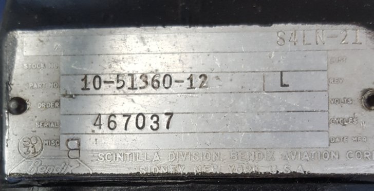

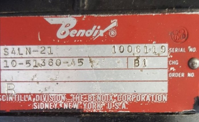

While I'm waiting on medical stuff I pulled my old Bendix mags out for a 500hr inspection. The mag fellow here locally suggests for a little bit more I should just get overhauled mags. They currently have 1900+ on them with various parts replaced along the way. He said one of them is so old he's not sure he can get certain parts so I'm wondering if it even has a core value!
Anyway, data plates below, don't know whether to go with Slicks or stick with the Bendix. I know the Bendix mags enought to repair/replace and have the Bendix harness (obviously) already, I guess I'm looking for a nudge or suggestions and what those in the know are leaning towards.

Re: Magneto question
Personally I would replace the older one with an electronic unit.
Much longer life. 2000 plus hours for overhaul, more reliable, better spark.
And have the other one overhauled.
I'm from the old, old, old school
keep the Bendix - case in point, look at the data plates on your mags - "old as the hills" and never been changed and your issue is maintenance and not failure. Granted Slick has greatly improved over the years as to quality but still not like Bendix. You probably have the late coils and distributor gears so I would just go for an IRAN vs complete OH. Re data plates, they changed color to blue when had factory OH.
Incidentally, Slick just recently came out with a service bulletin stating some mags were supplied with copper metal on the distributor gear carrying the high voltage current, ie auto distributor rotor, and they are recommending inspection and replacing the copper ones with one using "monel metal" for greater service life.
2c
PS I'm not saying yours have never been worked on - just that they apparently have never been thru OH where the data plates were replaced. Also, I think one will find that all the parts are still available!
PPS Last set I did the 500 Hr on was on my Bonanza with the 1200 series and IIRC correctly I don't remember changing any parts - after all its an "inspection" and not an OH. Then again, my work, my plane, my neck!!
2c
Roger that....
Just out of curiosity, if it's an S4LN-21 10-51360 mag are there certain dash numbers that pertain to an 0-200A?
Reason I ask is that Spruce supposedly has 10-51360-45's for $639 overhauled but don't list the -12's. Didn't know if they would take the -12 and give me a -45.
Really, what is is with all the different dash numbers
