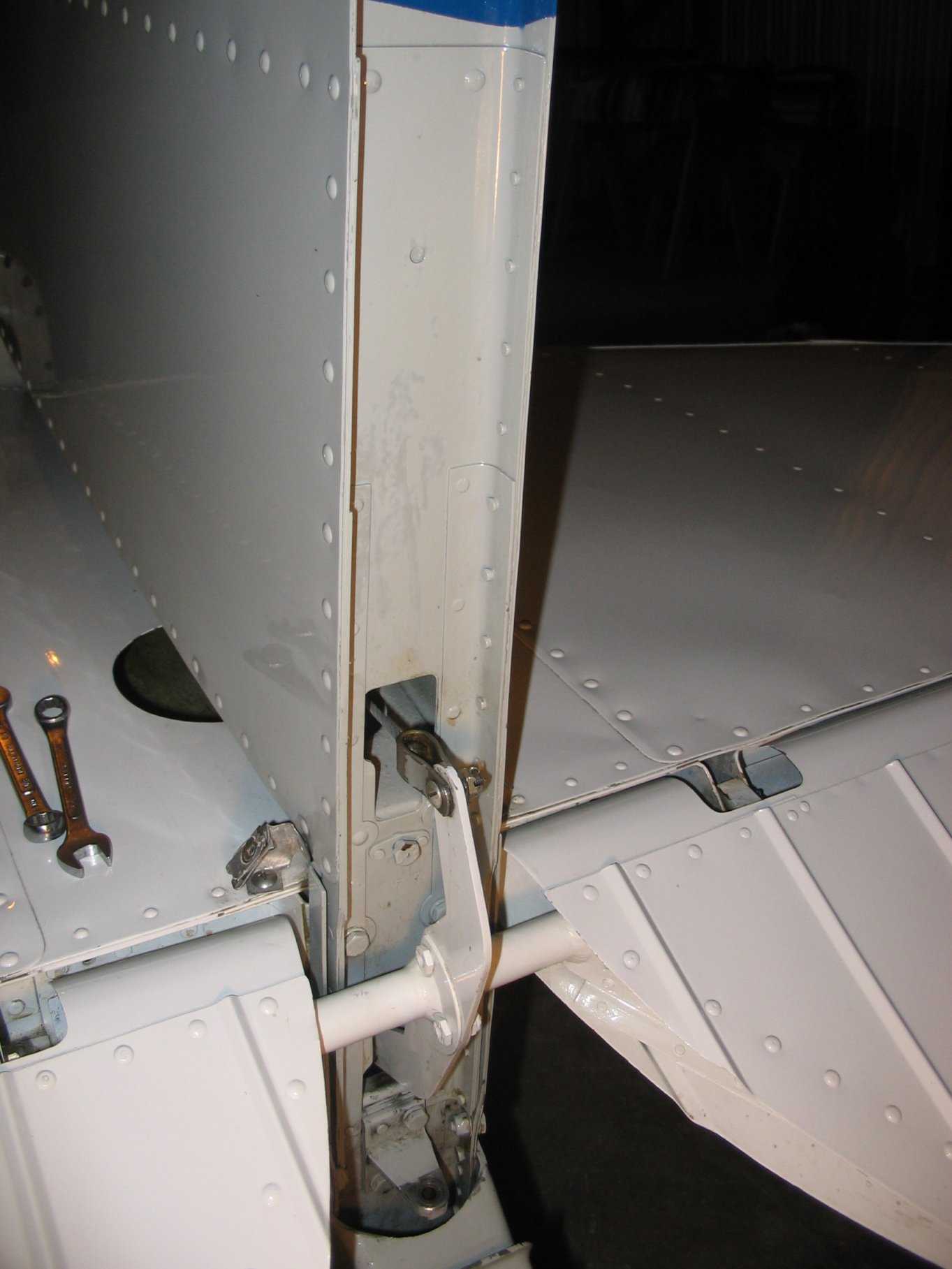

Just to be sure, does your elevator horn look like this one?
- finpostreinforcement2SL57-62A-62B.jpg (218.18 KiB) Viewed 12641 times

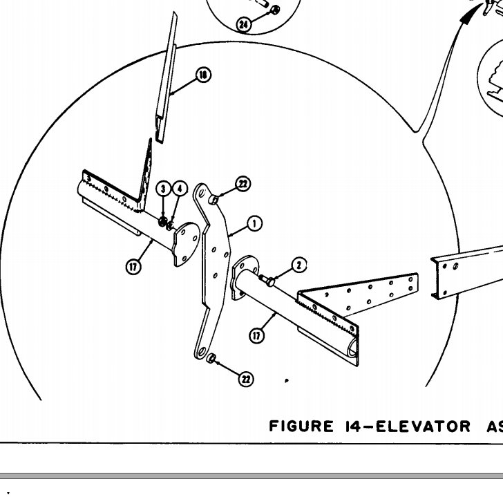

Here's what the parts book shows...
- finpostreinforcement2SL57-62A-62B.jpg (63.62 KiB) Viewed 12571 times

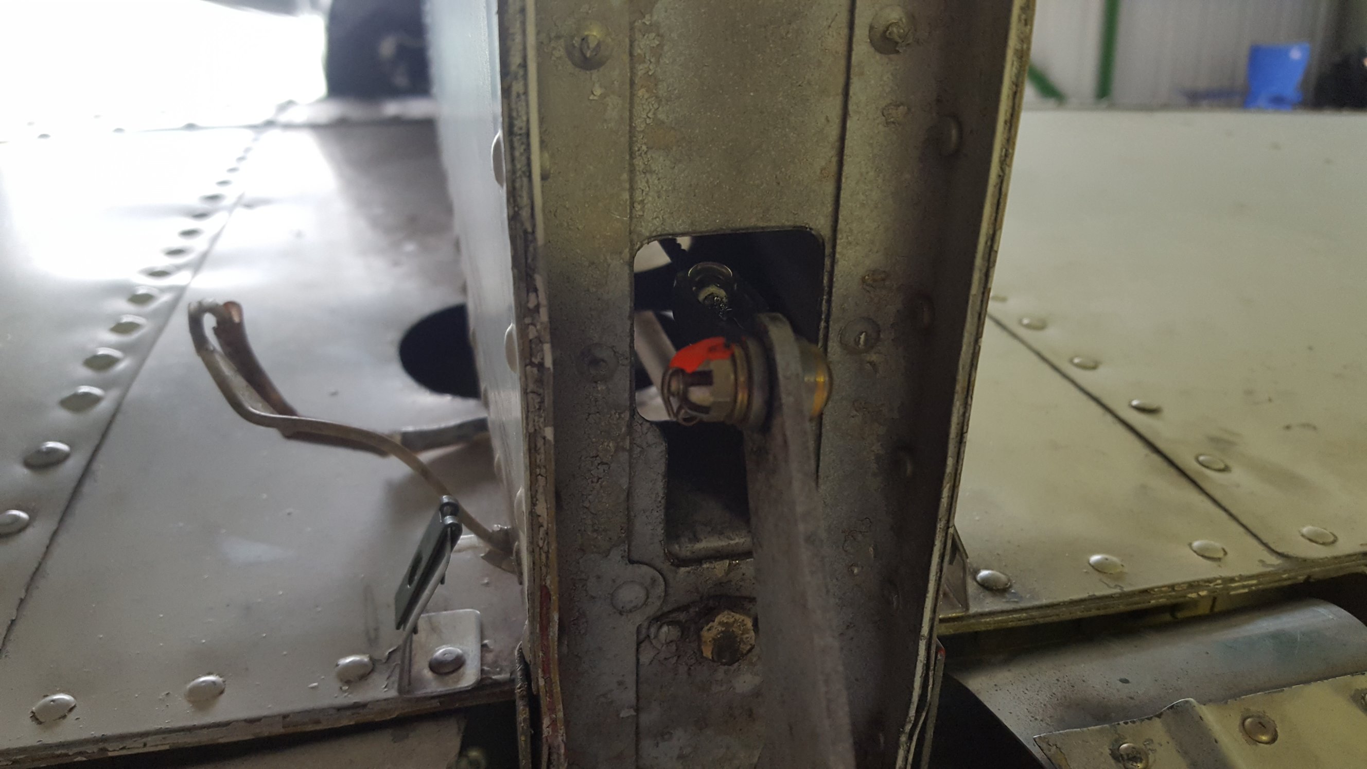

Check the bolts that connect the cables to the elevator bellcrank and thay they are not too long and hitting the side of the tailpost bulkhead where they enter.
Working on this plane today, notice that the castlenut/cotterpin needs enough clearance going into the bulkhead or you will lose quite a bit of travel.
- 20191021_105755.jpg (356.69 KiB) Viewed 12541 times
