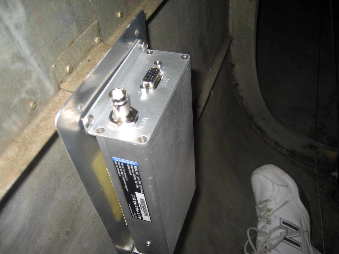

Mark wrote: "...GDL82 ASD-B upgrades..."
Hey, Mark, where did you mount the GDL82? Any issues that you ran into with the project that might help a couple of us who are poised to begin this installation? Thanks for any experience you can share! Mac

The GDL-82 was mounted just aft to the battery box, with the antenna mounted on top of the fuselage just aft of the baggage compartment. The mechanic the did the installation made a small mounting shelf that he riveted to the lower belly skin. It's ADS out only and the installation is very clean. The only issue we had was the transponder not passing the operation inspection.
As far as I can tell, I'd recommend the GDL-82 system for the basic compliance.

Marc wrote: "The GDL-82 was mounted just aft to the battery box"
Thanks, Marc -- that seems an excellent spot -- very similar to what Bill Rhoades is doing with his 120 installation (Following Bill's lead is always an excellent idea! ;) ). Mine ended up being near that location -- we "discovered" an old ELT mount already in place passenger side/adjacent to the battery & it worked well with little modification/reinforcement & adding a mounting plate (...trial fit in photo -- shoe is not part of installation :roll: ). Since I needed a new transponder anyhow (...KT76 had served me well since 1987! :D ), I opted for the GTX327 and the Garmin combo cert/flight tested 100% & has worked flawlessly. Running/routing wires, especially the stiffer 400 coax was a bit of a challenge, but overall an easy installation...great to have it done in any event. Mac

Looks like a nice, clean installation. I am trying to stay away from all the modern flight navigation systems and that is why I opted for the basic installation. I am very pleased with how it all turned out.
