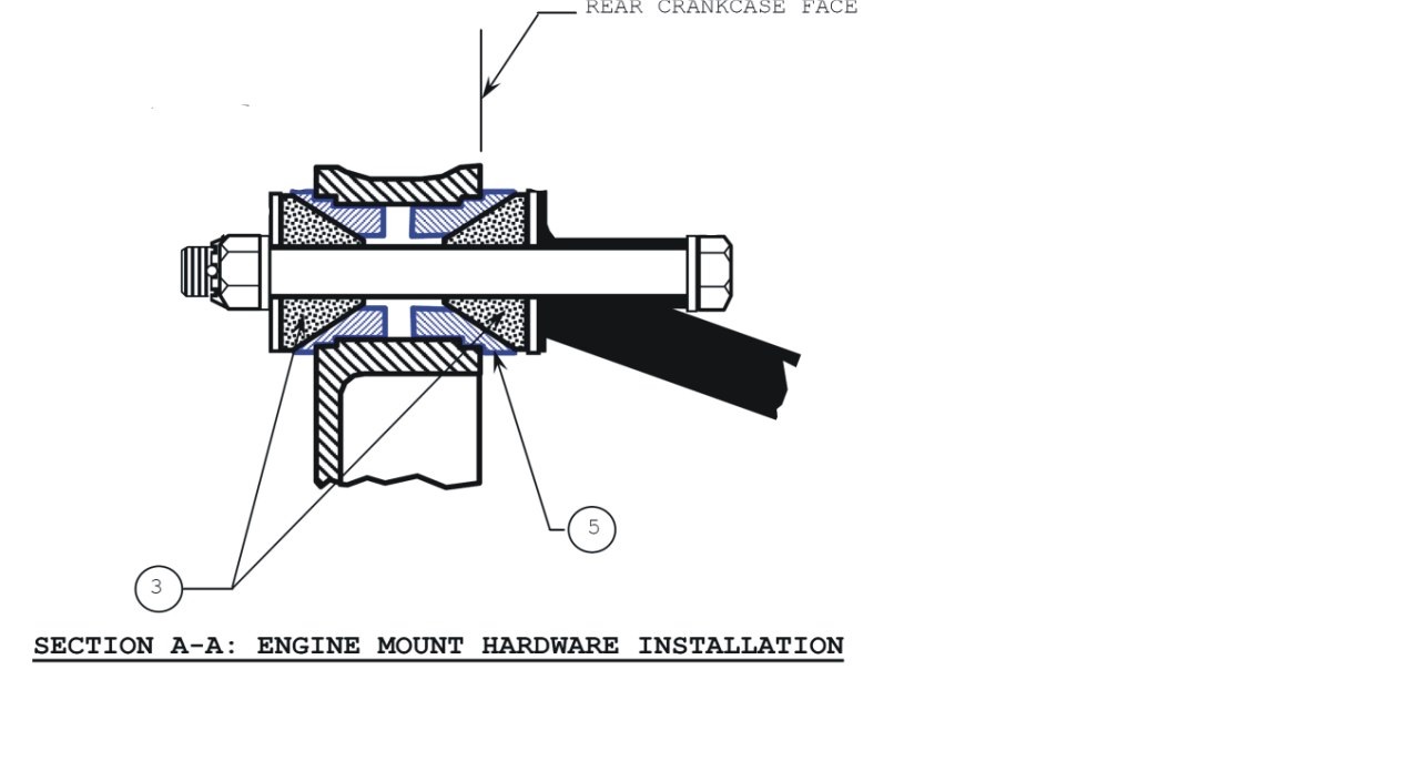

There used to be a guy who sold adapters to use the conical mount on the O-200 on E-bay, but he seems to have disappeared. He also had a web site, http://www.continentaladapter.com/ but all I get is a blank page. I know some people who have used them in the past and gotten them approved. Or, if you're handy with a lathe, you could whip up a set.
Conical adapter.jpg (74.72 KiB) Viewed 7659 times
