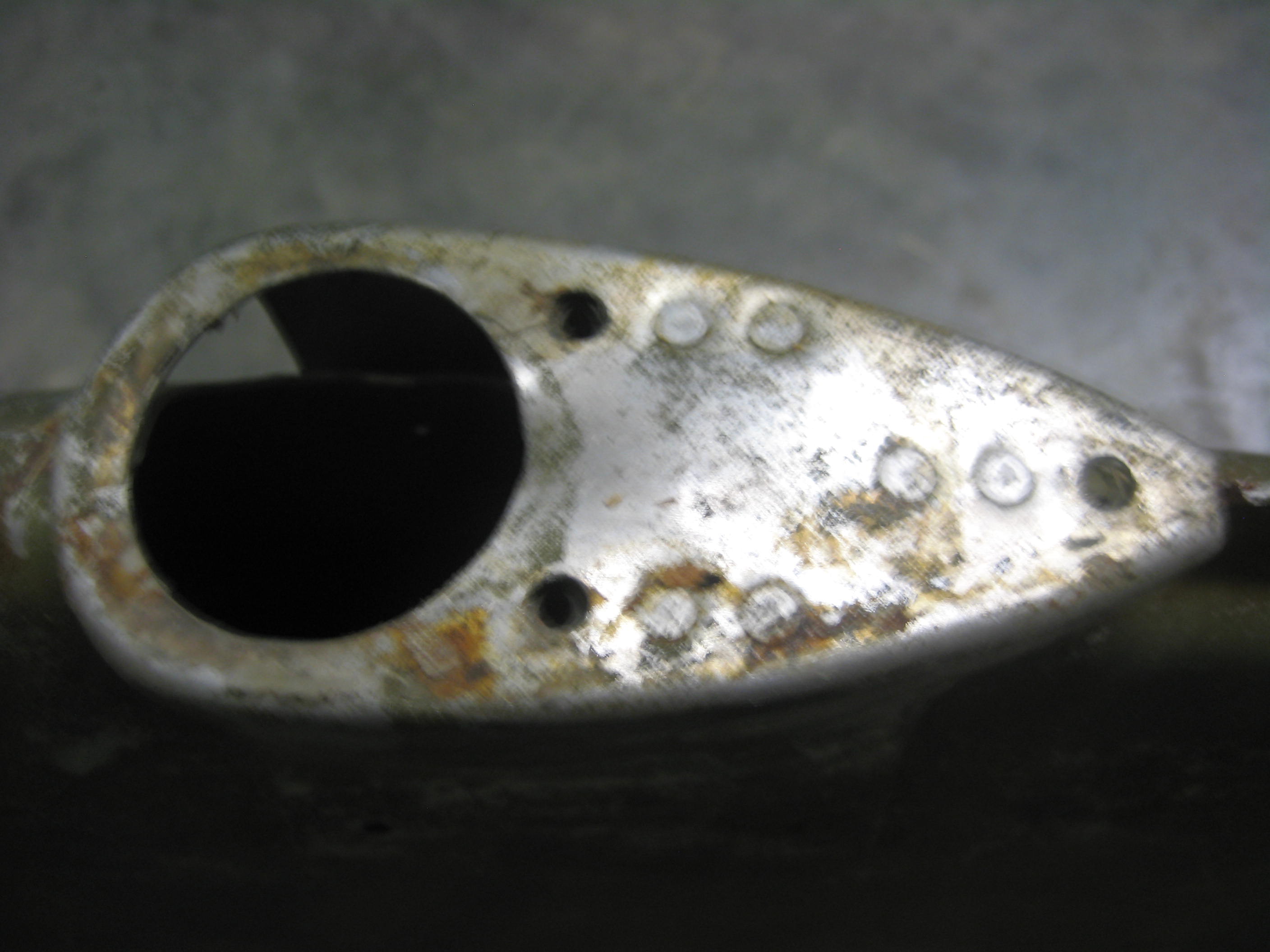

Re: ADS-B skySensor
Steve wrote" "... non existent tinnermans".
I've looked at a few wingtips & see that some have nut plates (like this one) and others don't. Rivnuts can be great solutions.
