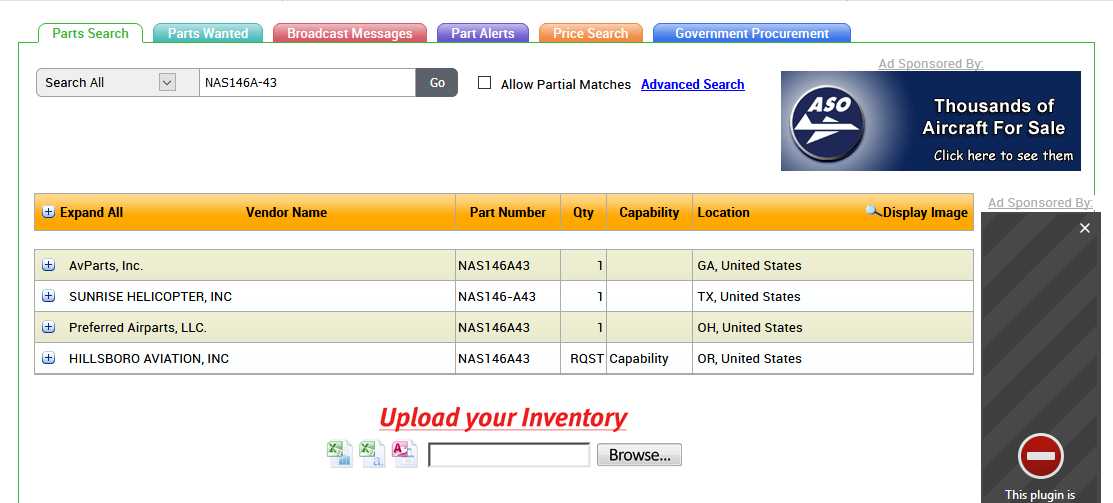

Just did a quick search. I found 3, at 3 different places. I'll ask a buddy who has access to a better database.

Jay-Tex Aviation 903 572-3688 Reportedly has 7. $60 minimum order.
Air Cargo Carriers 414 482-1711 x 7188 reporting 11 available.
Both New Surplus.
Both New Surplus.
