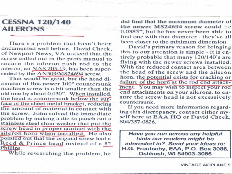

I recall some discussion on the bolt that attaches the operating rod to the aileron itself, see attached-
My ailerons droop maybe .5" at rest on both sides, and raise with pressure in flight. Can't seem to get that droop adjusted out on the ground without overly tightening up the cross cable. Works fine as is.

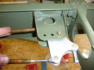

I recall initially setting the bellcrank angle so that the rear edge is 90deg to the mounting bracket edge (see image) before adjusting the push rod to give the aileron neutral position.
With this set, setting the control column to neutral by fixing them together with a section of wood and some cable ties... Once this is done then adjusting the tension to 20lbs. Seem to recall juggling the turnbuckles to get both the tension and the neutral position set.
