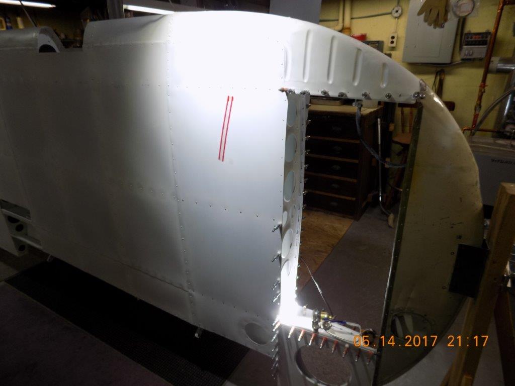

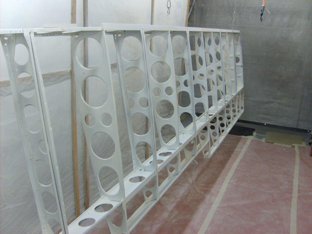

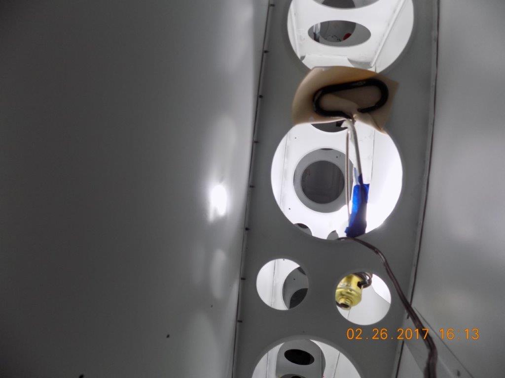

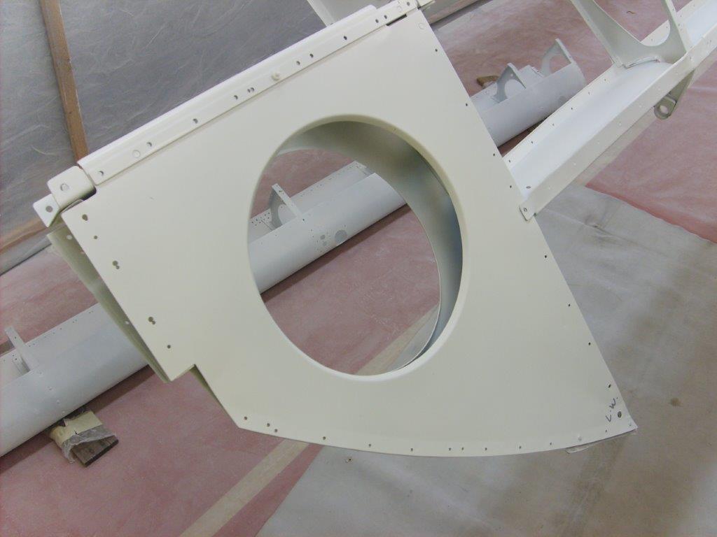

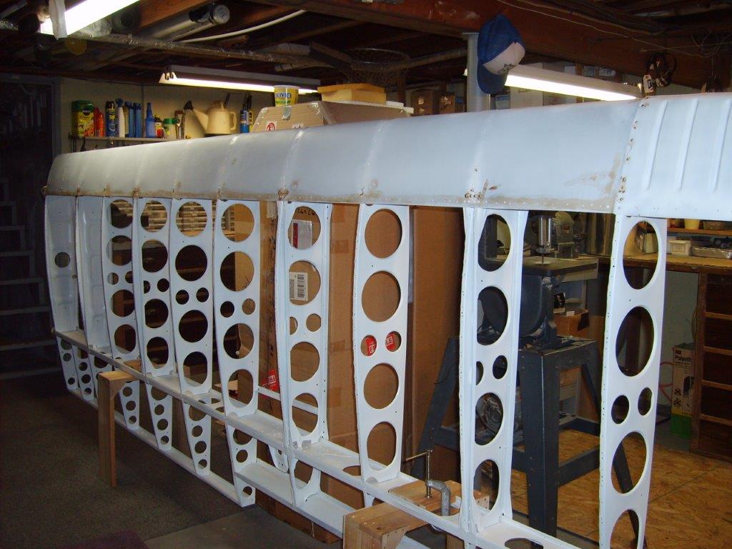

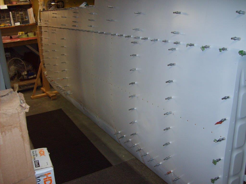

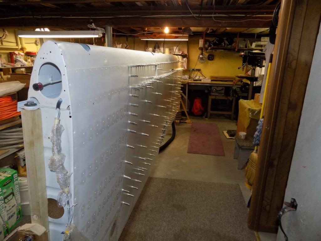

Here are some photos of my wing re-metallization project on my C140.
- S5004853.jpg (118.32 KiB) Viewed 8610 times
- S5004806.jpg (87.32 KiB) Viewed 8610 times
- S5004777.jpg (157.69 KiB) Viewed 8610 times

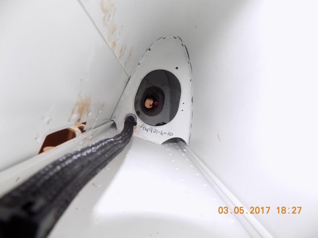

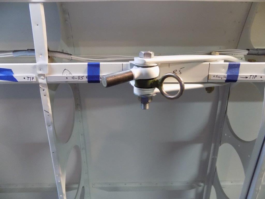

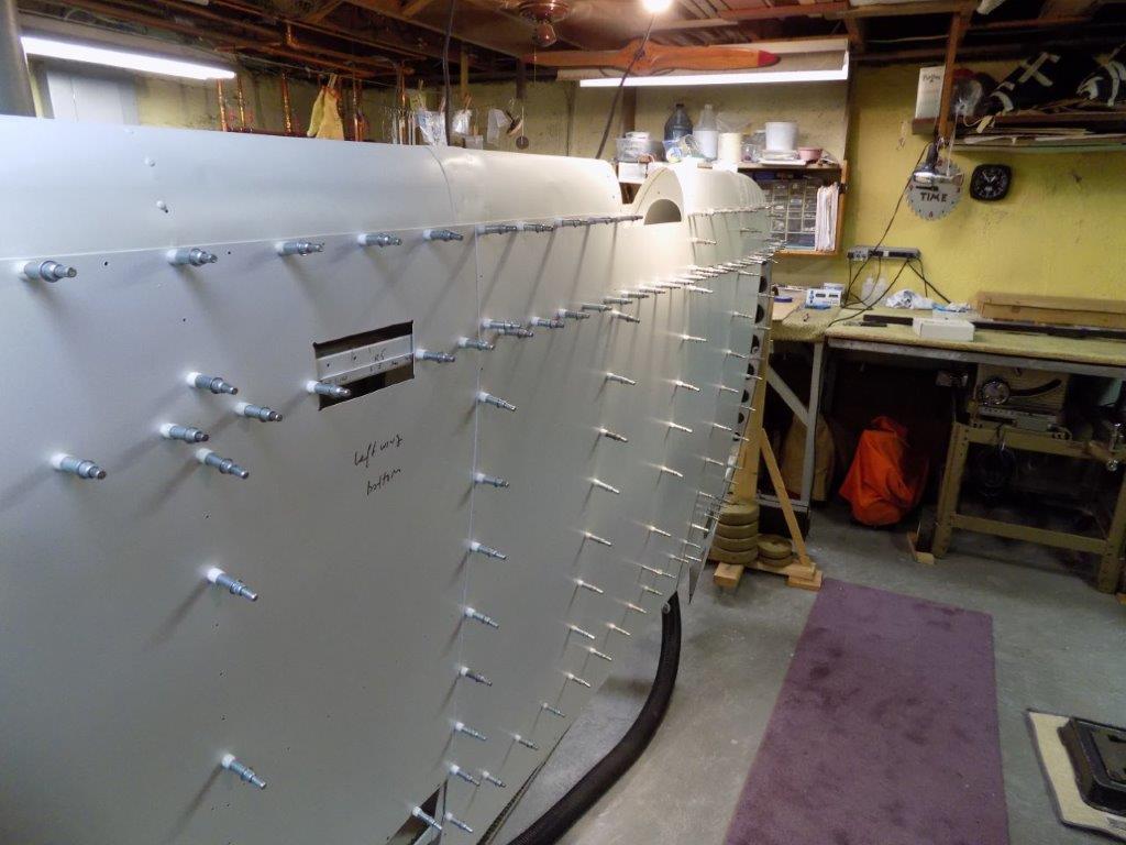

Re: Cost to Metalize

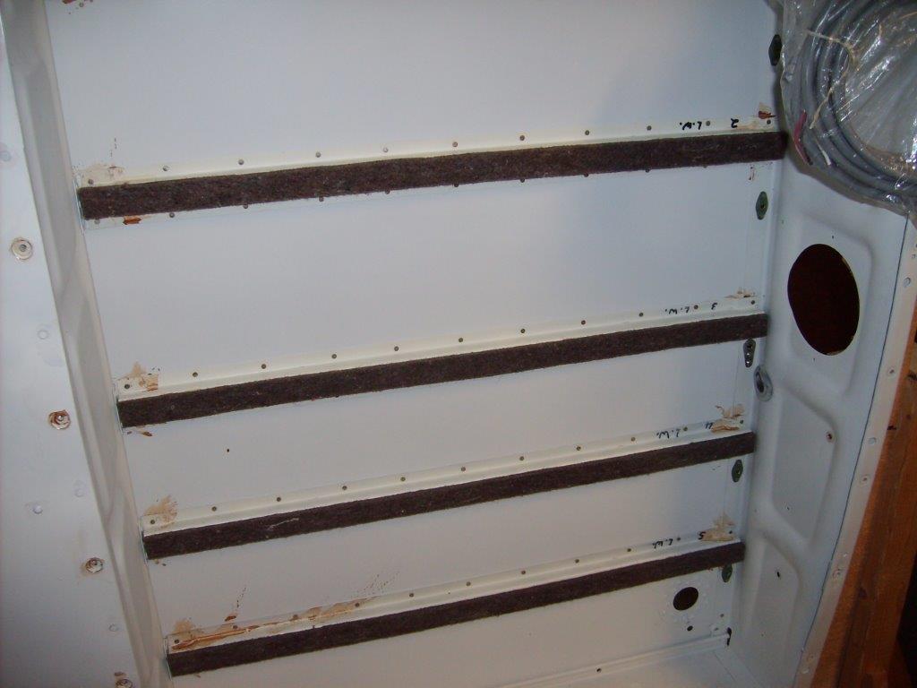

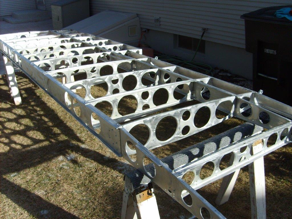

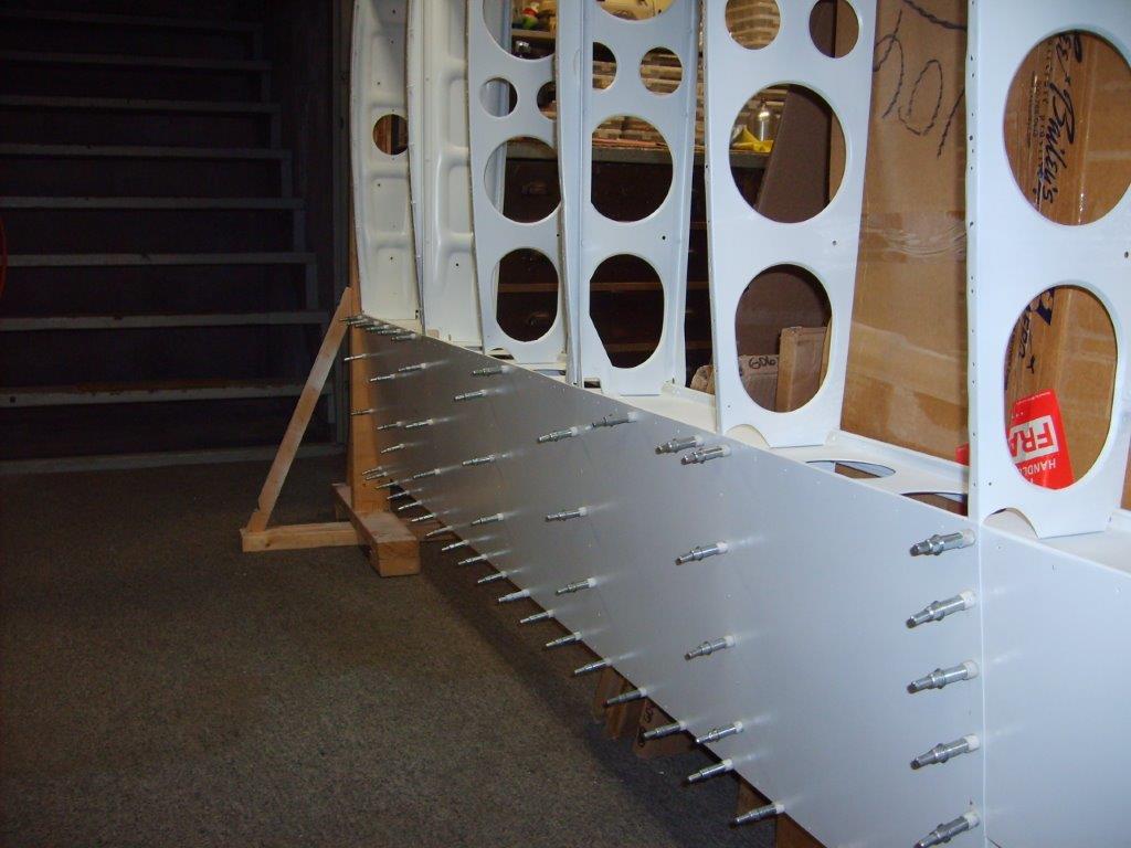

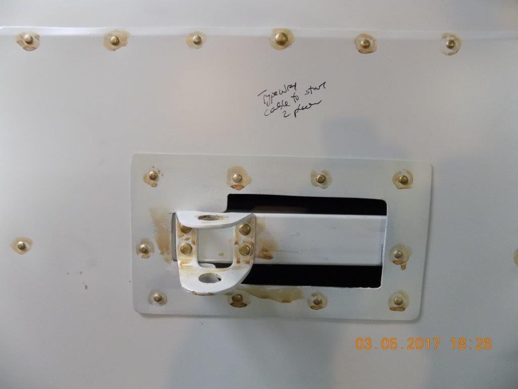

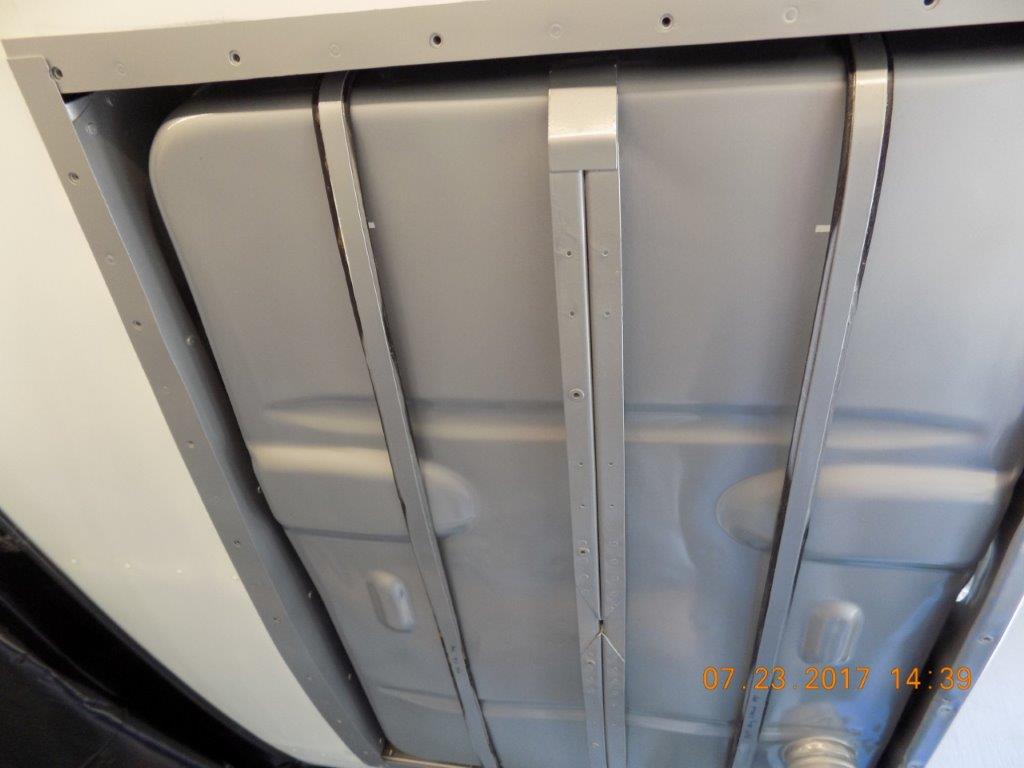

More photos.
- S5005058.jpg (80.14 KiB) Viewed 8610 times
- S5004968.jpg (69.63 KiB) Viewed 8610 times
- S5004934.jpg (88.92 KiB) Viewed 8610 times

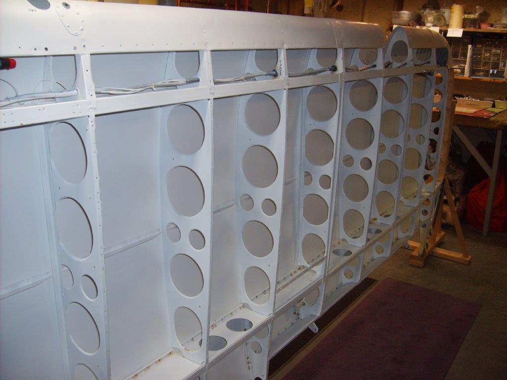

More photos
- DSCN0621.jpg (62.07 KiB) Viewed 8610 times
- DSCN0526.jpg (62.04 KiB) Viewed 8610 times
- DSCN0511.jpg (95.86 KiB) Viewed 8610 times

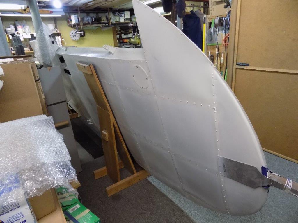

Some more, but I have many, many more.
- S5005067.jpg (65.34 KiB) Viewed 8610 times
- S5004829.jpg (60.83 KiB) Viewed 8610 times

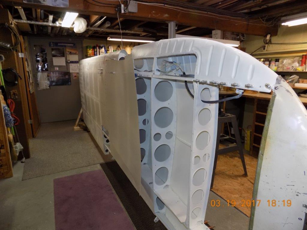

More photos
- DSCN0486.jpg (40.22 KiB) Viewed 8608 times
- DSCN0480.jpg (42.34 KiB) Viewed 8608 times
- DSCN0471.jpg (45.66 KiB) Viewed 8608 times
