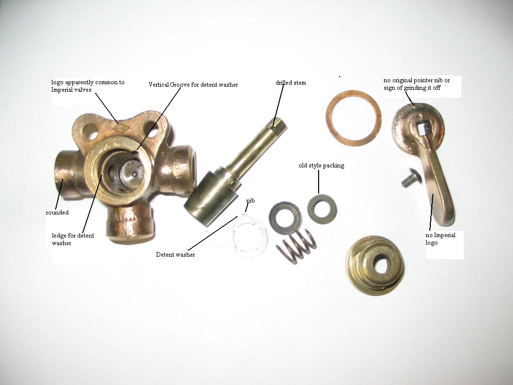

Is it leaking from the shaft packing? If it's the original Imperial valve, there should be a leather packing under the big nut. You can try "rejuvenating" it with Fuel-lube (now EZ-Turn) or there's a post here somewhere about replacing it with a pair of O-rings. Years ago I fixed mine with one o-ring and a spacer, but the double o-ring idea sounds easier.

Assuming it's the old brass on brass valve, left-right-off, then all you can try is drain all the fuel and remove the bonnet of the selector, clean and dab/smear just a little EZ Turn fuel lube on the truncated cone. Re-assemble. If the brass cone/seat is really scored you'll need to look into another valve (check UNIVAIR). There is a packing under the bonnet where the valve stem comes through. An M83248/1-109 o-ring is what I've been told. One member used a fat fuel injector o-ring Napa # 2-12085.

Here's an example of an original fuel selector Left-Right-Off so you can see what you are dealing with. Pretty simple. You don't need to remove the valve body from the aircraft to do the basic maintenance.
