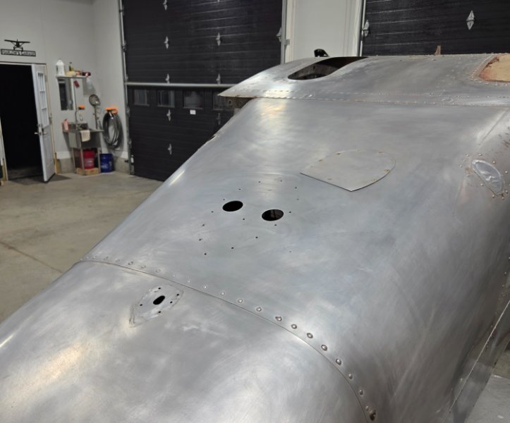

Hi all,
I am planning to replace the aft/upper fuselage skin on my 140 to repair some holes left from an old antenna install.
Does anyone have any experience with skins from Univair? Do they fit well or would I be better off to cut one from a sheet?
Thank you

I made mine by using the old one as the pattern/drill blanket. Laid the new piece of aluminum on a sheet of MDF with the vinyl protection (if it has one) against the MDF. Placed the original skin on top with the outer surface against the new sheet. Start drilling near the center and work out while clecoing the stack to the MDF as you go. Additional clamps may be required along the outer edges to hold the old skin tight to the new skin. Using the old part to match drill the new skin will result in a perfect fit.

8425 wrote: Thu Dec 11, 2025 8:14 pm I made mine by using the old one as the pattern/drill blanket. Laid the new piece of aluminum on a sheet of MDF with the vinyl protection (if it has one) against the MDF. Placed the original skin on top with the outer surface against the new sheet. Start drilling near the center and work out while clecoing the stack to the MDF as you go. Additional clamps may be required along the outer edges to hold the old skin tight to the new skin. Using the old part to match drill the new skin will result in a perfect fit.
'This would be my preference. My airplane got smashed in a windstorm in 1991. I replaced many skins this way.........they all fit great and cost .........zilch. (compared to a supplier)

I had a belly skin with a couple of nasty wrinkles that would not lay flat, so I cut out the worst areas. This allowed the skin to lay out flat but the perimeter needs to stay intact so that the fastener holes are accurately located.
