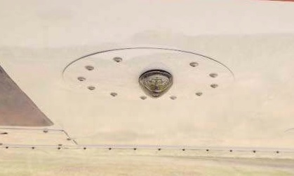

http://www.aveoengineering.com/downloads/VegaTL-TLR.pdf
This is the unit he used, but they do things a little differently down under as far as certification or owner maintenance. There is no STC that I know of here in the states. He has since sold the plane and doesn't have any other details on the lights. I could not find any type of lumen/candela rating on the TL model he used so I could not compare it to the standard 250watt GE4522 bulb. I would really like to lose the weight of the Grimes also.

Yes I remember reading the article in the Newsletter and was curious also about that landing light. Still I don't understand how the light can project forward??? Anyone has an idea?
Because the link provided by David doesn't see to be the same model as the one we see in the picture. Reading the manual, very interesting technology.
