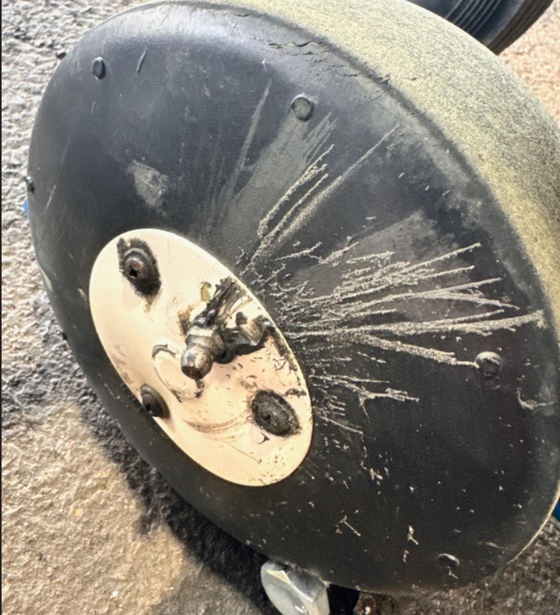

Our tailwheel grease fitting/zerk has gone missing. Does anybody know the part #/size to replace it with? I've attached a picture we took right before the zerk departed the airplane.
(alternatively, is this a suitable replacement for the whole plate+zerk assembly? https://www.wagaero.com/wheels-brakes-t ... pma-d.html)
Thanks in advance!

Mine was bent like that and just screwed into the thin hubcap. I replaced with one from Napa with 1/4 28 threads and put nut on backside. Working fine 600 hrs. The clearance on the back is very tight, but it does clear the axel nut.

Thanks! I went ahead and purchased the one from Napa, but found that, even properly torqued, etc, it still leaks grease, as the opening through the hub cap is now oversized. Looking to purchase a replacement hub cap, but unfortunately, Wag Aero has gone out of business (and Aircraft Spruce doesn't yet list the part). Right now, we have duct tape covering the opening, and that seems to be doing the trick.
Back to he drawing board ...

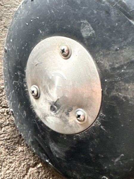

Well, we replaced the whole hubcap with a new part from Aircraft Spruce, and about 30 flying hours later, the zerk fell off again (see pic). Second departed zerk in less than 100 hrs.
Our workaround is to simply grease-pack the bearing by hand (by completely removing the cap), and then, after re-installing the cap, we'll permanently cover the zerk hole with some heavy duty duct tape.
Does anybody have a more elegant solution?

What does the zerk screw into? Try some red loctite. Or, can you put a nut on the back side? (Or both...)
