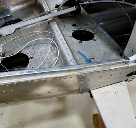

As we go through the airframe, the squawk list continues to grow. We found both lower door sills cracked. Proximity is slightly aft but over the main gear attach. Maybe hard landing? Anyway, researching new parts with Univair as they have them listed. Notification of not in stock. My choices are to make a “nested” repair per AC 43.13 or fab a new part. Yes, I’m the A&P/IA on the project.

I’m working on adding a picture,,, but it’s saying the file is too large. Working on reducing.
