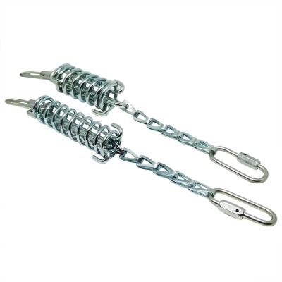

What worked for me, to eliminate the maule shimmy, was to take out the free slack at the arms -not tight, but just enough to eliminate the free slack with the wheel centered.
- Posts: 600
- Name: Mac Forbes
- Location: North Carolina
Re: maule tail wheel
John K's post mirrors my experience...and, I'll admit, too, that impatience prob led me to go back to the "little" Scott TW, 'though I did like the larger Maule. Mine was a "gift" from a friend after I spied it laying under a work bench. He'd experienced similar frustration with shimmy. We phoned Maule for help...phone actually rang @ home of B.D. and June Maule and June answered...offered advice and took our order for some OH parts. My experience was that after OH (new bushings & swivel parts) the tailwheel didn't shimmy, but was a bit stiff on swivel. As it "wore in" it began to function perfectly...yay!...no shimmy & swiveled just right. Then, as it loosened up a bit more...back to the ole shimmy. They DO work for a lot of folks -- the special "anti shimmy spring kit" (above...note different spring size L & R)) and a read of Neal Wright's article (viewtopic.php?f=10&t=147) may provide the solution that really works(?).
Mac
Mac
- Posts: 2780
The shimmy damping effect is due to the different spring rates, resulting in different resonant frequencies. There is a reported issue with those springs. They are called compression springs. As the chains "stretch" the springs compress, and they have a hard limit (solid length) as to how far they can compress. When you hit the limit, all the stress is suddenly transferred to the rudder bellcrank, and it is not unheard of for them to be found damaged. Not proof of cause and effect, but something to consider.
