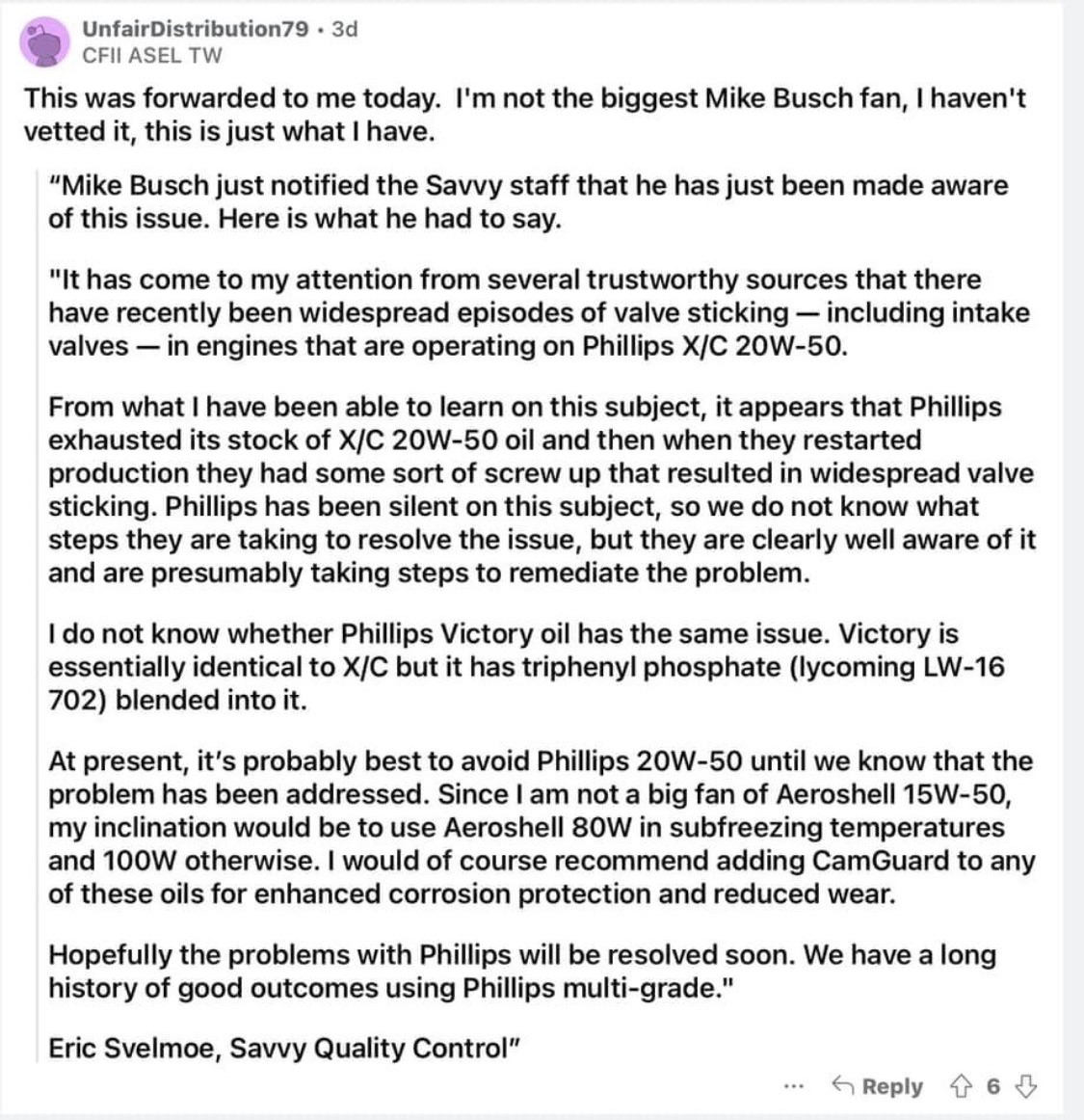

The attached was forwarded to me by a friend of mine. I don't know if it is true...or just internet BS. Has anyone heard anything about this?
- 20-50 XC Problem Potential Problem.jpg (313.91 KiB) Viewed 3188 times
