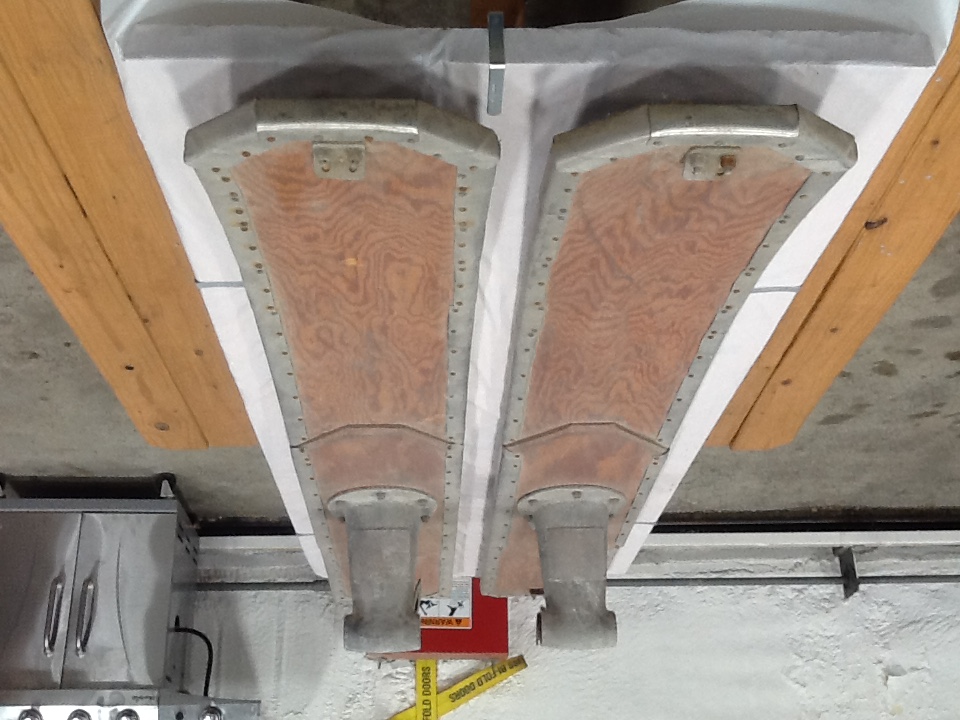

Our EAA Chapter here in Fairbanks has a set of Wesco model A20 skis. These are listed as approved on the Cessna 120/140 Type Certificate Data Sheet. As well as probably a number of other aircraft with a gross weight of up to 2000 lbs. These skis look to be in quite good condition. They will of course need cables made up to suit your particular arrangement of fuselage fittings. Instructions for proper rigging are in AC 43.13-2A, Chapter 5.
Anyone interested in buying these skis, please contact me through this site for more information.
Thanks, Bill
