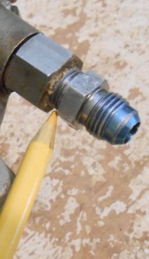

Does anyone know part number on Carb fitting
b61652
- Posts: 16
- Joined: Wed Jul 17, 2019 3:47 pm
I am looking for the part number for the fuel fitting the flared one on the Marvel Schebler carburetor wondering if anyone could help.
- 7068E1B1-491A-41C6-A2ED-CCFA58FCD9F3.jpeg (83.75 KiB) Viewed 1181 times
- Posts: 710
Re: Does anyone know part number on Carb fitting
The blue AN fitting?
Pretty certain it's an AN816. Since I'm not at the airplane I can't be certain, but I believe it's an;
AN816-6D Meaning the pipe thread is 1/4" and the tube size is 3/8's that would take an 11/16's wrench(on the B nut of the fuel line). Take a look at that and see if it lines up with what you have
