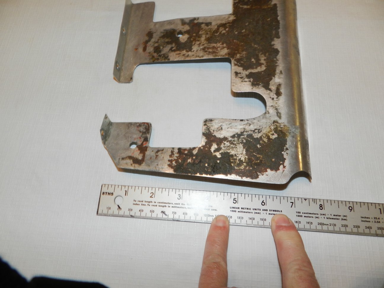

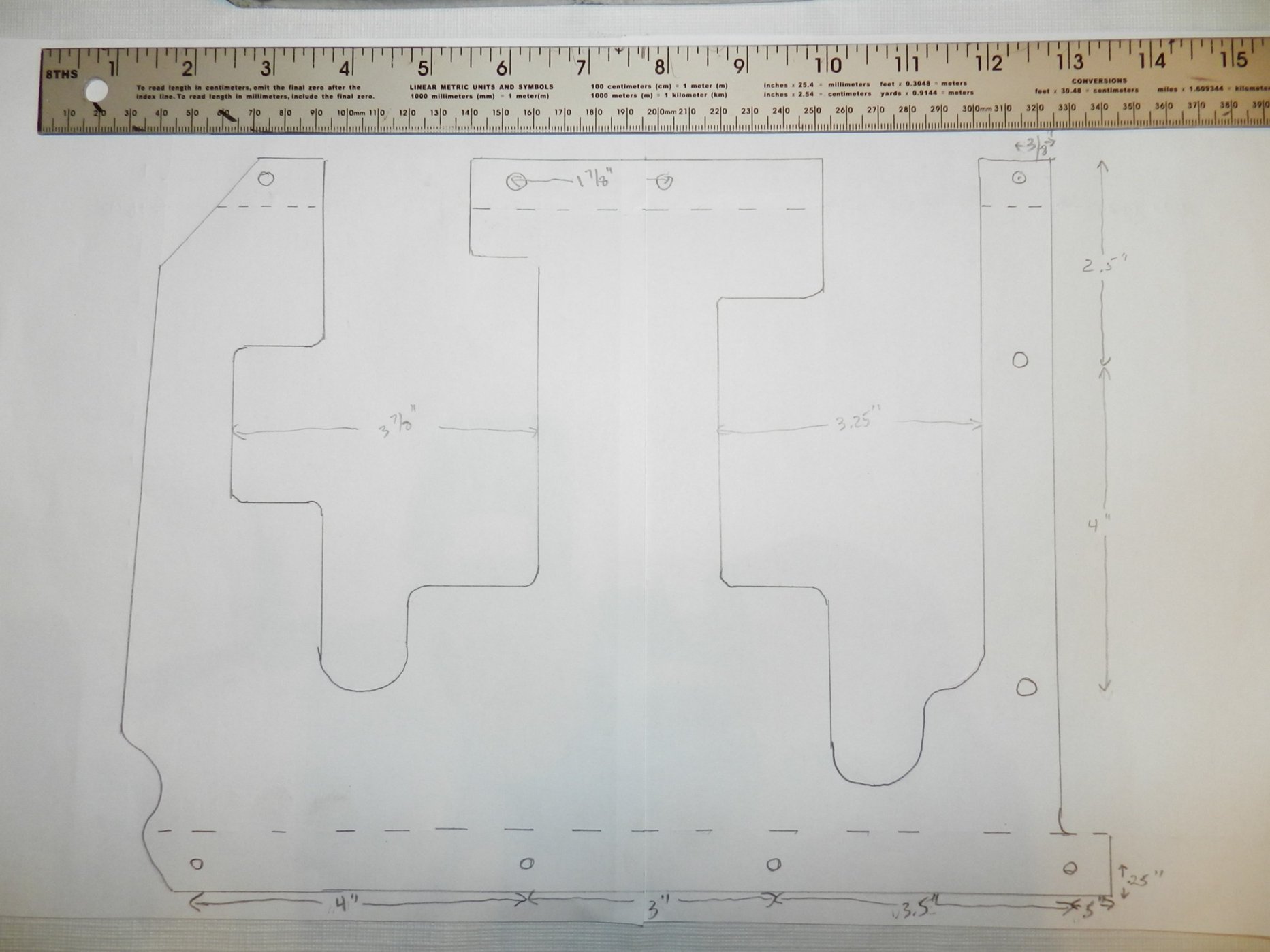

Here's what I have, but Steve may have the easier answer...
- DSCN3436.JPG (221.05 KiB) Viewed 7456 times
- DSCN3437.JPG (184.68 KiB) Viewed 7456 times
- DSCN3441.JPG (211.38 KiB) Viewed 7456 times

thank you, that will help a lot!
