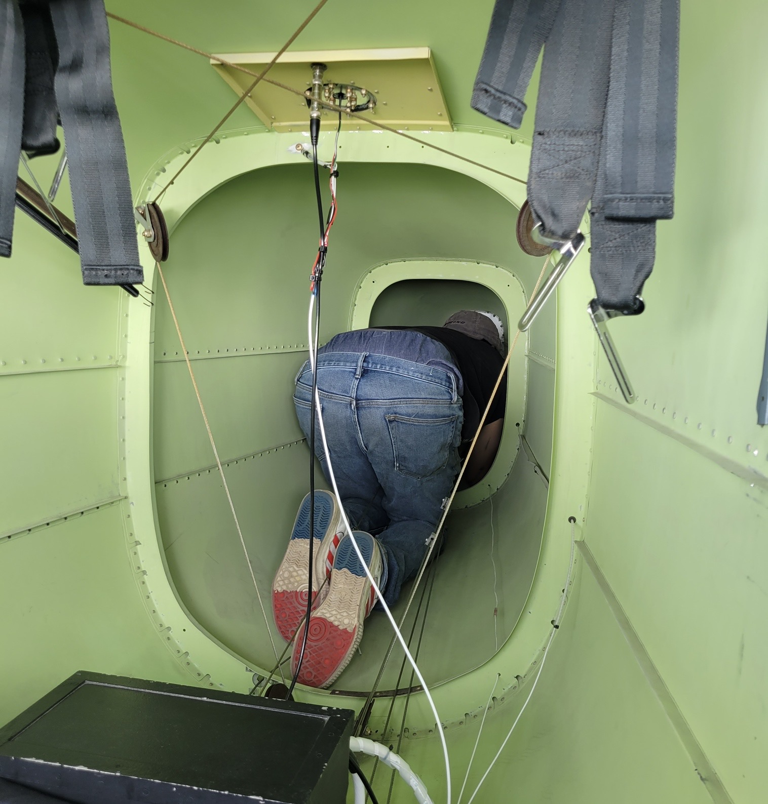

My son (who is building time for commercial rating) convinced me to buy a tail pull handle. I said sure as long as you crawl in…
Yes, leveling the plane on sawhorse (under a bulkhead of course) and some padding material make it easier. As well as someone who treads carefully.
We teased him the whole way cause his pants started to slide off. Wish I had a video of him getting past those initial cables, wires (didnt know he knew how to cus like that) and battery box. Plus he is skinny. I’m too robust and old to be that nimble.
While your back there you might as well clean it out good.

Just remove the current X-ponder antenna and relocate farther forward? Where it's easier to work on?
In the picture above with the owners son stuffed in the tail cone, you see a doubler on the top of the fuselage just aft of the battery?
That is where I put my GPS antenna. The Garmin GDL 82 was mounted on the side of the fuselage, to the right of the battery box, but aft of the baggage compartment. (left side of the fuselage looking forward)
The antenna was below the GDL 82, at about the 7 O clock position with a 90 degree coax connector so it wouldn't interfere with the control cables.
Big Edd said "KISS principal" by all means!
