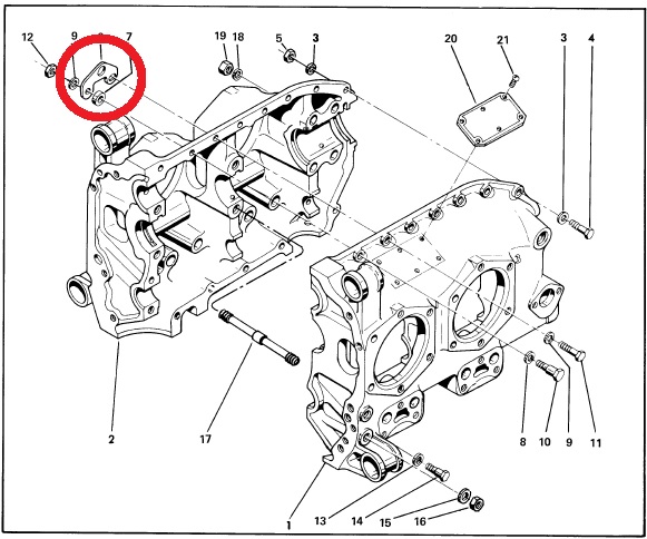

Hi,
I'm wanting to change my bushings as well. I'm not sure where exactly to hoist the engine from. The only thing I've found is lift from "lifting eyes" on backbone of engine - I don't think I have that installed or lift from the crankshaft with prop removed (ref. OH manual). C-85-12F.
Thanks!
Nick
Thanks!
Nick
- Posts: 2791
- Posts: 562
Re: Changing Rubber Engine Mount Cushions
https://www.fresnoairpartsco.com/produc ... e-lifting/
Fresno Airparts also has the correct crossbolts and spacers.
